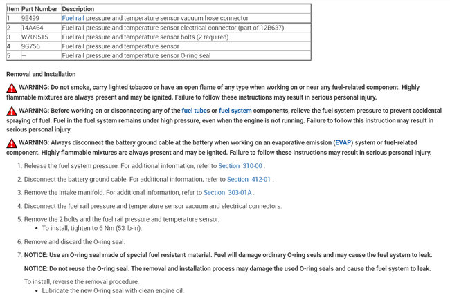

Is the fuel pressure regulator a preset mechanical pressure or is it controlled by a vacuum?
276,000 MILES
ABREWER
Fuel pressure regulator. The vehicle listed above is an XLT 4.0 VIN-D.
May 30, 2022 at 2:32 PM
  • 55,684 POSTS

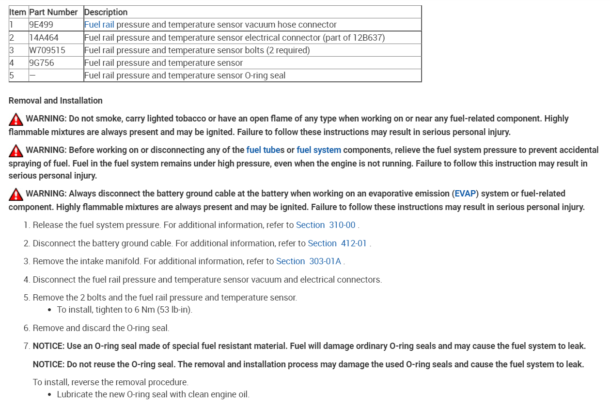

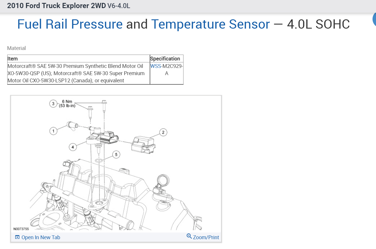

The fuel pressure is controlled by the fuel pump which has an internal pressure regulator. There is a fuel pressure sensor through which helps control the pressure, the location I have included in the diagrams below. Check out the diagrams (below). Please let us know if you need anything else to get the problem fixed.
