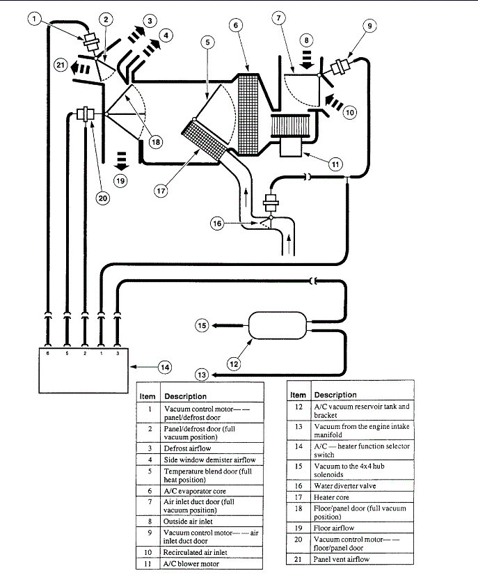

The vehicle listed above is an XLT. Check engine light with codes P0171 and P0174. It doesn't want to go away. I've replaced the 02 sensors and MAF sensor and the EGR and replaced the intake gaskets and some vacuum lines. I don't know what could be causing them, but the car runs great! I do have a problem when I accelerate with the air on it switches to defrost and I have an OBD reader, and the only the light was not working on it is the EVA light and I don't know what it means if I could get some help that would be amazing!

Both codes indicate the engine is running too lean. In most cases, it is caused by an engine vacuum leak. Here is the interesting thing. Since the HVAC controls are vacuum operated, the leak may actually be in the vehicle. Do you notice any hissing or odd sounds when the airflow direction changes? When you accelerate, you open the throttle plate on the throttle body. By nature, which causes the intake vacuum to lower. It could cause what you experience in the vehicle. Pay close attention to the vehicle to see if you can hear any leaks. Also, there is a vacuum reservoir I believe under the dash for the HVAC system. It could be what is leaking. See pic 1 below

Since you experienced the airflow change, I feel somewhat confident that you have a leak allowing the vacuum to drop. Using the link above, see if you can find any.

Hi Joe, thanks for this info. I will be sure to listen when I drive and it's not fuel pressure and I will be sure to check the vacuum reservoir!
