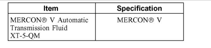

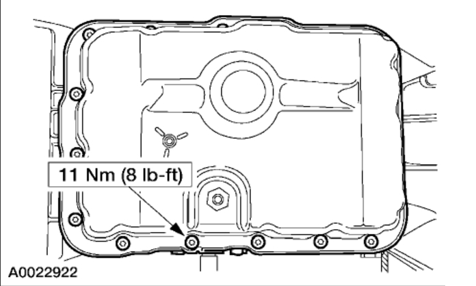

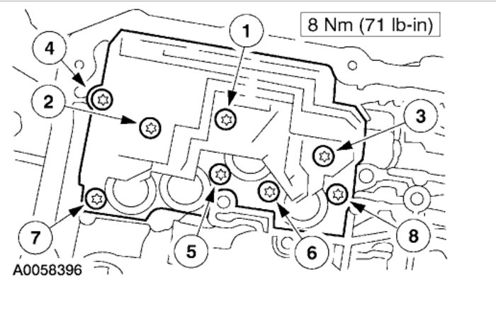

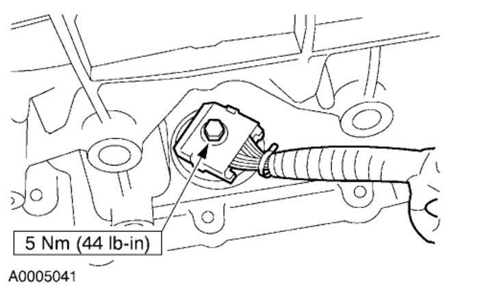

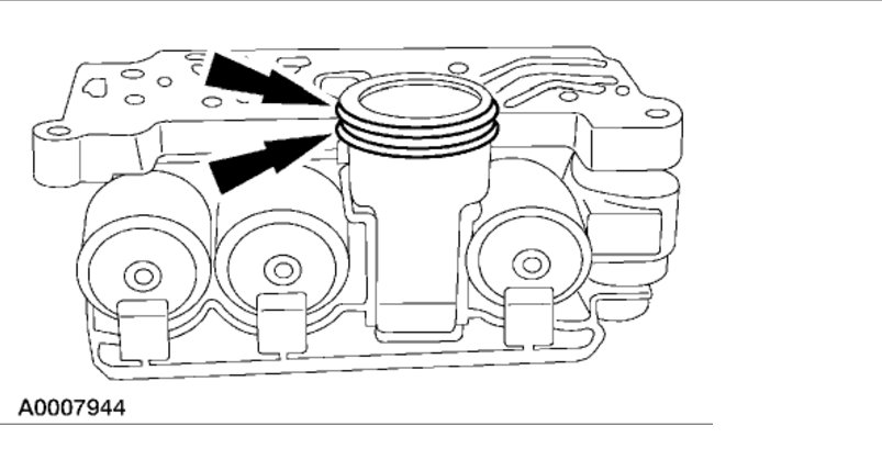

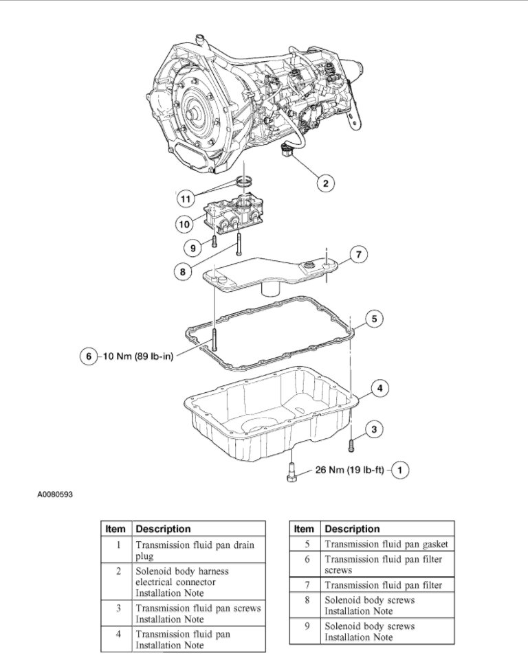

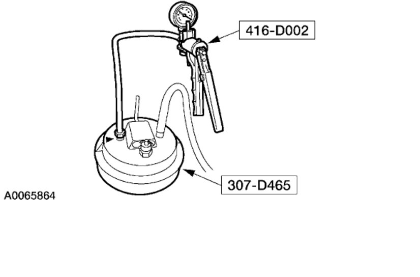

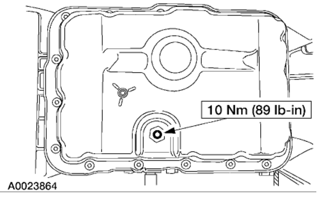

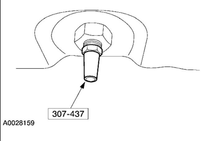

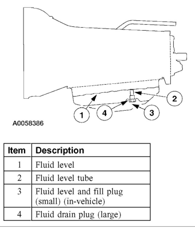

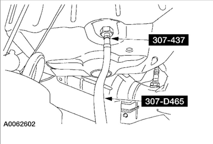

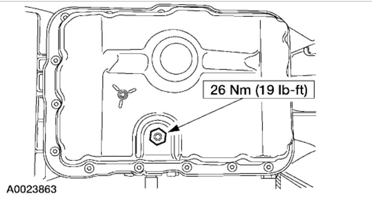

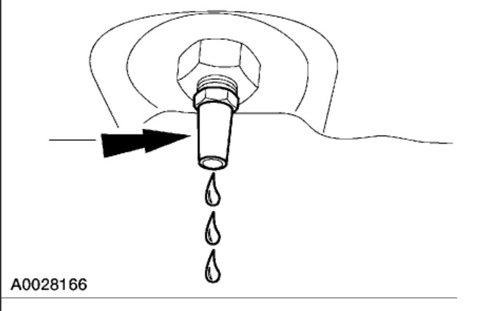

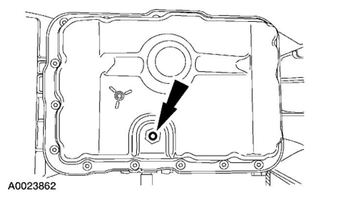

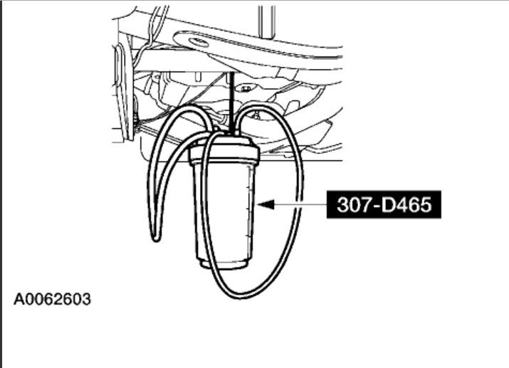

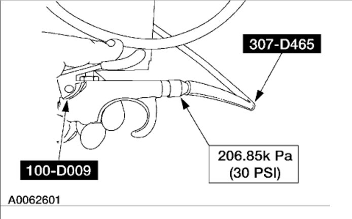

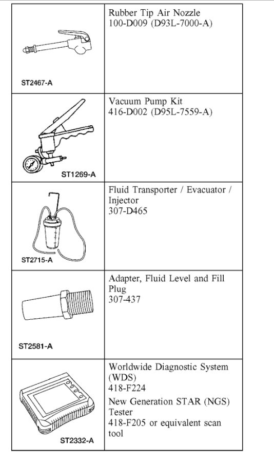

Hi. your car has no trans dipstick. it is designed to be serviced from the bottom here are instructions in the diagrams below to show you how. You pump the fluid in from the bottom and the excess runs out. Check out the diagrams (Below). Please let us know if you need anything else to get the problem fixed.

To Whom It May Concern; I thank you for taking time out of your busy day to help me. I'm trying to locate my transmission filler plug. With this particular model explorer there is no dip stick. I've drain my transmission fluid cleaned the pan and magnet replaced filter, replaced gasket, now my easiest task just became my toughest. PLEASE help me locate my transmission filler plug, as you know I cant move it with no trans. fluid PLEASE HELP and again I thank you

There is no filler plug on this model..the tranny is "sealed" and only supposed to be serviced by Ford with a special machine that pumps the fluid out and in.
