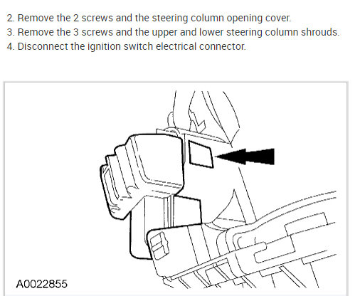

I was told that my Explorer has a bad ignition switch. It will not turn over, I have had the battery checked as well as the starter and all the fuses, they are all fine but because my door alarm, when the key is in the ignition, does not work, they tell me it is this switch. Are they correct and if so, where is it located?
Thank You for any help,

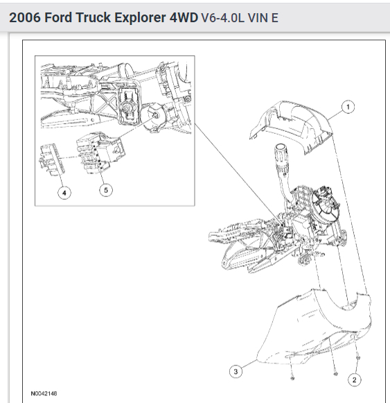

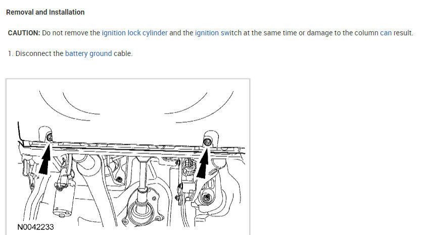

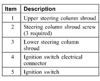

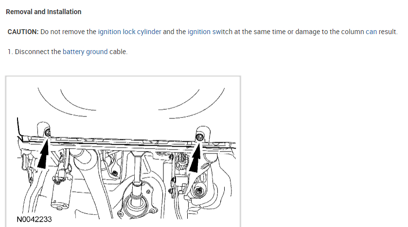

Here is the information you requested. I've attached picture steps below showing the location and replacement of the ignition switch on your vehicle. Hope this helps and thanks for using 2CarPros.
