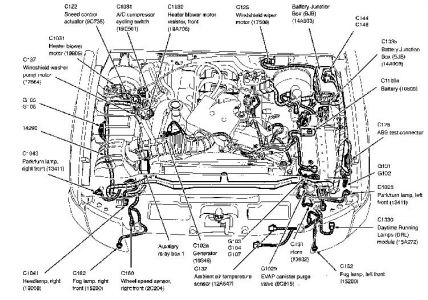

hi, I hope you can help me I have a problem with my Sport trac when I'm fueling the gas keep stopping the fueling and some times the fuel come back out. Can you help me and tell me What is causing that?

Suspect faulty EVAP Canister Purge Valve, located at the left front corne of the engine compartment (pictured below).
https://images.2carpros.com/forum/automotive_pictures/261618_Noname_240.jpg
