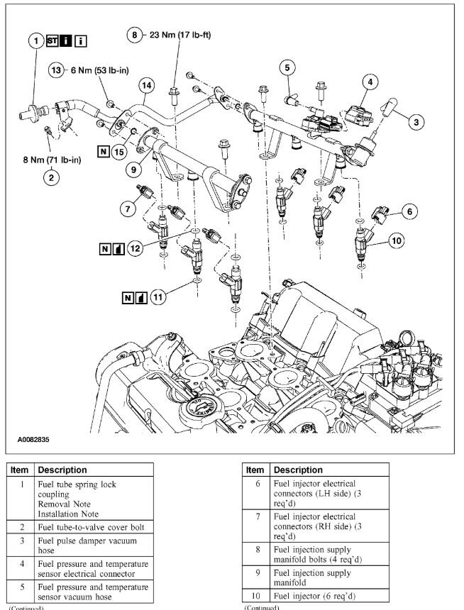

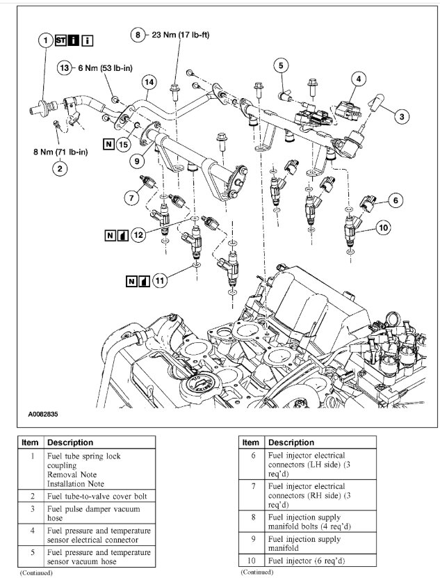

Where is the fuel rail sensor located?
Jul 1, 2010 at 7:32 PM
SATURNTECH9
  • 30,869 POSTS
Here's a blown up diagram of the fuel rail and all of its components. Check out the diagrams (Below). Please let us know if you need anything else to get the problem fixed.

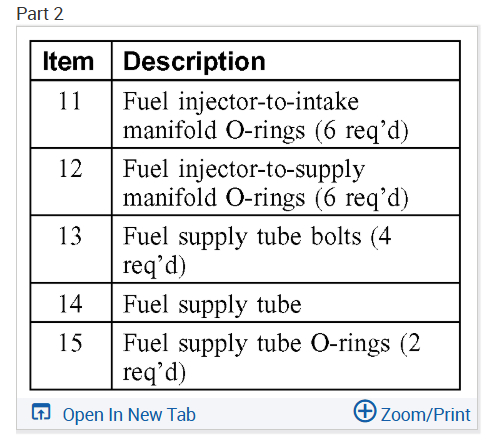

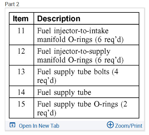

What is the part number to number 14 on this image?
Mar 1, 2025 at 6:53 AM
  • 54,837 POSTS
That is called a fuel rail supply line. They sell the rail together.
Fuel Rail part# 1L2Z9D280ED $208.33
Check out the images (below). Let us know if you need anything else.
