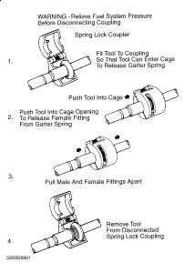

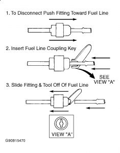

any advice on discocting fuel line at fuel pumpnne
