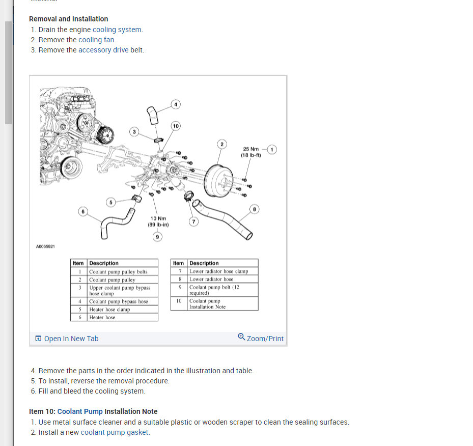

I have a coolant leak that wont stop moving.I have replaced the thermostat, the thermostat housing, radiator, waterpump and hoses and I still have a leak behind the pump. What could it be? And how do I fix it
Wednesday, July 21st, 2010 AT 10:16 AM

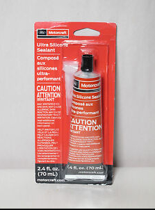

More then likely you have a distortion on the mating surfaces so what I would do is remove the gaskets and replace them with gray RTV.
Here is a guide that will help with replacing the water pump and thermostat again which is what you need to do in order to replace the gaskets:
https://www.2carpros.com/articles/water-pump-replacement
Below you will find the process from the manual which will help with the detail.
Let us know if you have other questions. Thanks
