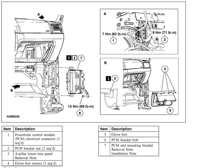

I'm trying to locate the computer module to get the keyless entry code. So far I haven't found it. Please suggest where it might be.

The location of the engine control module is located in the passenger's compartment behind the glove box on the right side. Here is some diagrams to show you what I am talking about. (below)

It's usually located in at least two places, on top of the keyless entry module and on top of the pcm, usually the keyless module is located on the on the package shelf in the trunk in the sedan models, on your explorer I'm not familiar with the setup of your vehicle,, the pcm unit is located usually above the glovebox, you mat have to pull it, get yourself a repair manual, Chilton's whatever, it'll help you.. worst case scenario, the Ford dealer can extract it from the pcm unit, however you'll pay... I've searched my manuals and discs high and low for info on how to perform that operation and I can't find anything on it..

it is located left side of steering column at firewall. keyless entry code is on entry module behind glove box. be very careful not to trip the air bags they are yellow connectors.

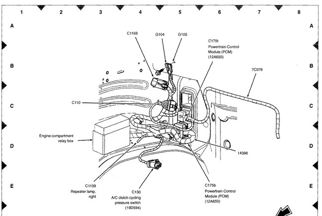

Where is the computer module located in a 2000 for explorer

Powertrain Control Module (PCM) is located through firewall, pictured.. 4.0L Engines
https://images.2carpros.com/forum/automotive_pictures/261618_Noname_245.jpg
5.0L Engines
https://images.2carpros.com/forum/automotive_pictures/261618_Noname2_73.jpg
