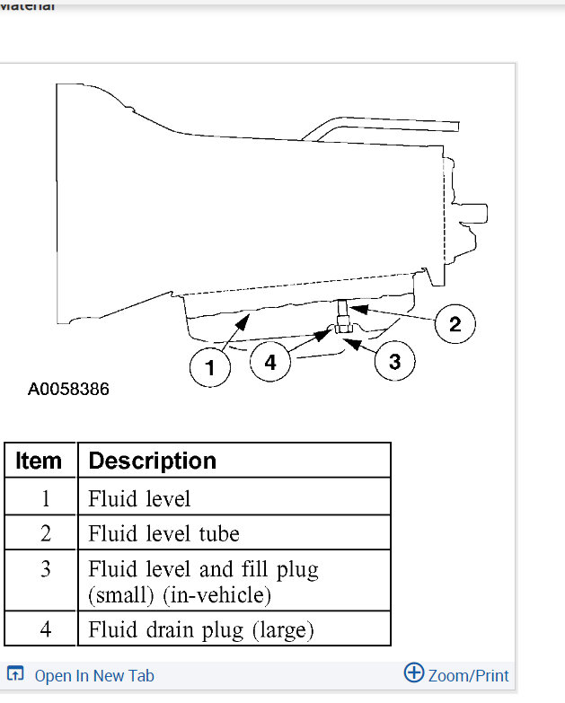

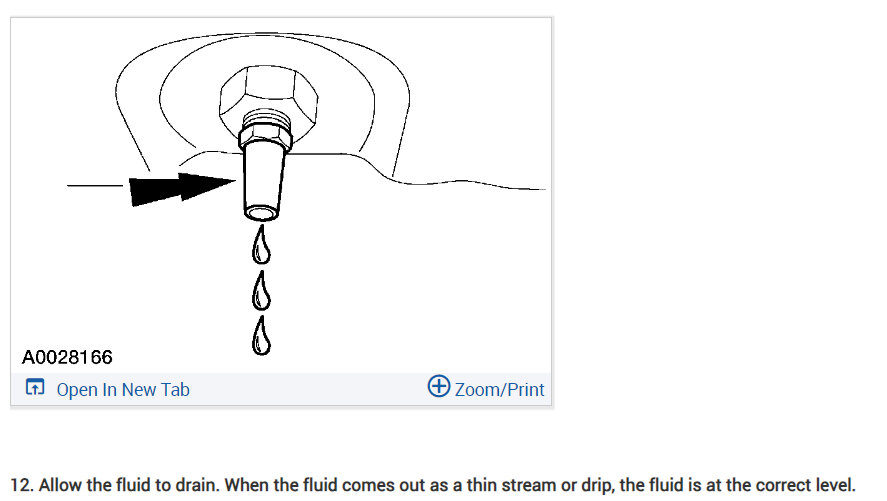

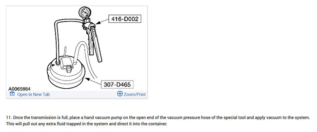

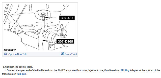

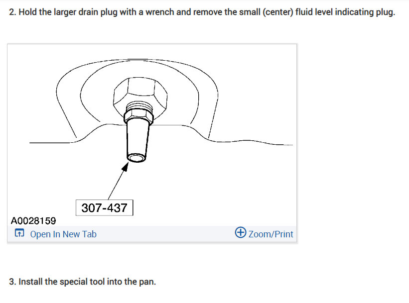

sounds like its low on fluid
Dec 9, 2007 at 12:21 AM
  • 55,554 POSTS

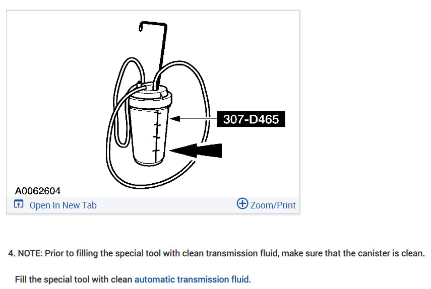

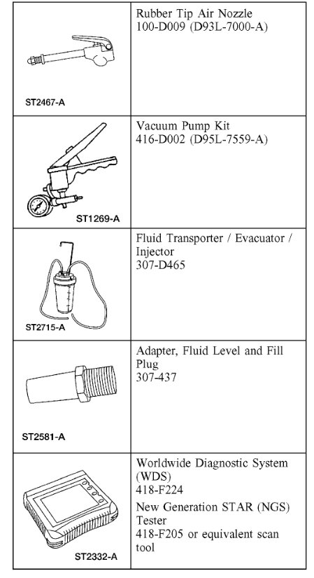

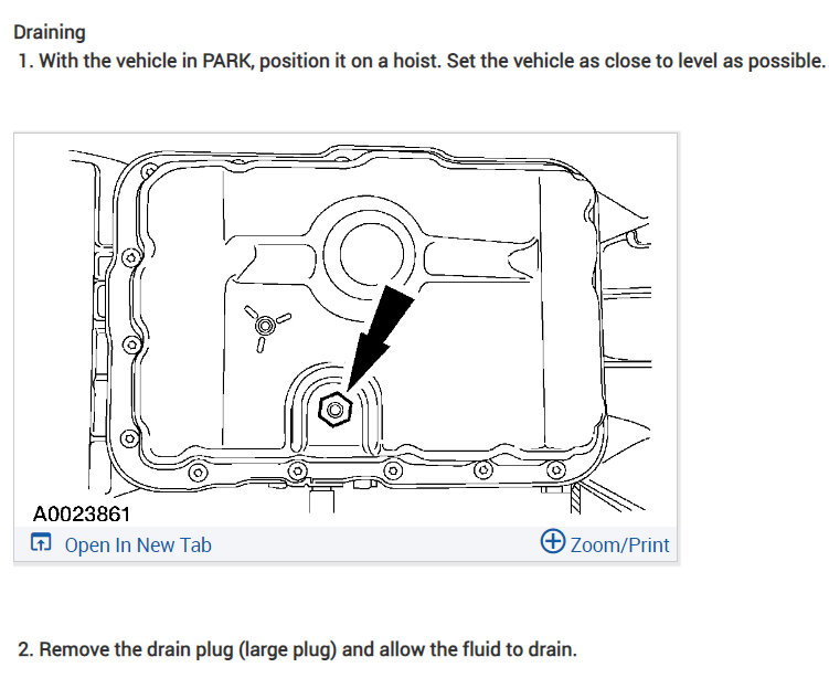

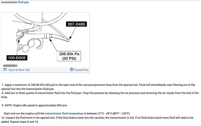

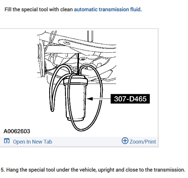

Yep, I would start by checking the fluid here is a guide to help. I have included how to check the fluid on your car below which will take special equipment.
https://www.2carpros.com/articles/how-to-check-and-add-transmission-fluid
