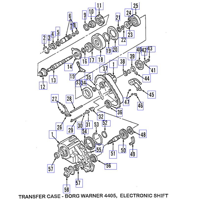

After accelerating the car to about 30 - 60 mph and I let off the gas pedal so it can cruise and deccelerate. A thumping sound begins inside the car. Outside the car a grinding sound begins same as the thumping inside.
When I push on the 4X4 high button, the thumping stops but the grinding outside changes to a continuous grinding sound.
When I push the 4X4 auto button it returns back to the thumping inside coinciding with the outside grinding/thumping.
I changed the tires and had a wheel alignment thinking they were the cause but they were not.
Hope these symptoms help in your diagnosis.
Jan 9, 2009 at 5:41 AM
Good morning,
This sounds like the transfer case itself is the issue.
When was the last time you changed the fluid? If it is low or the fluid is old, it will not lube the internal bearings and this is the result.

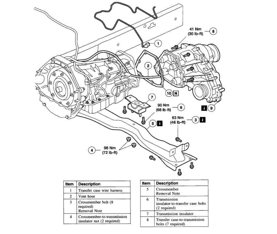

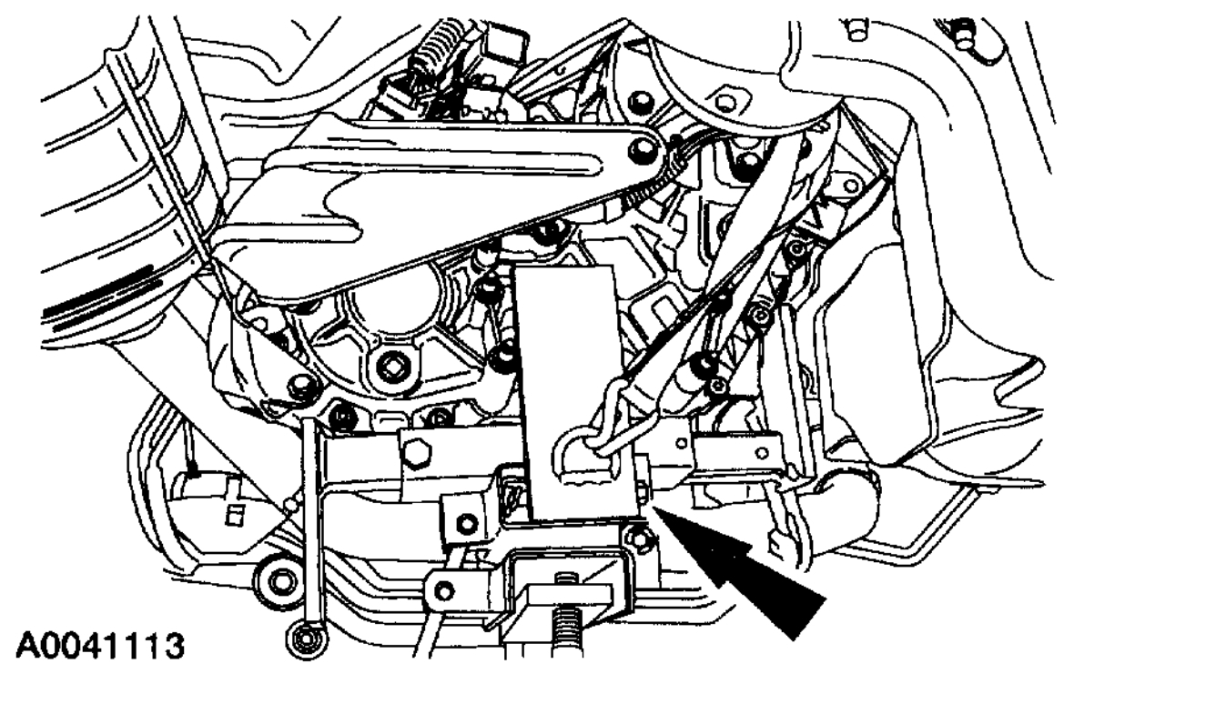

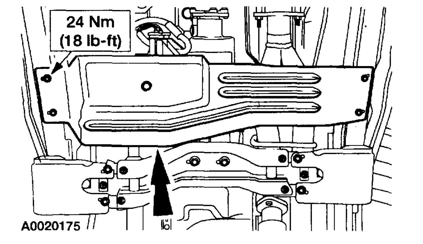

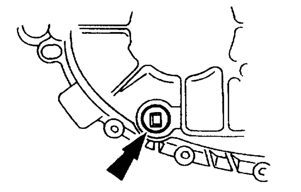

I posted the procedure for replacing the transfer case below.
Transfer Case
1. Remove the upper radiator fan shroud.
2. Remove the rear driveshaft.
3. Remove the front driveshaft.
4. Remove the four bolts and the skid plate, if equipped.
5. Drain the fluid if the transfer case is to be disassembled.
6. Remove the RH and LH heat shield-to-crossmember bolts.
7. Remove the components in the order indicated in the illustration and table.
8. To install, reverse the removal procedure.

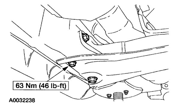

Item 3: Crossmember Bolt Removal Note
1. Remove the eight crossmember-to-frame bolts.

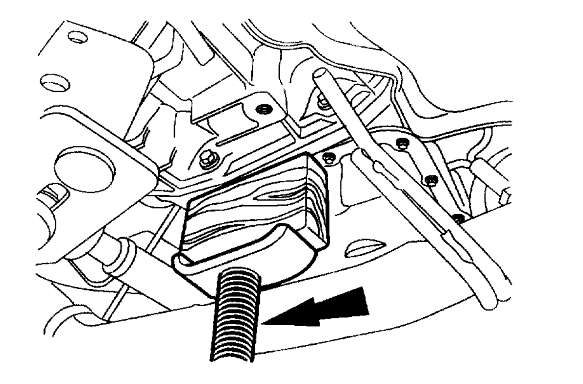

Item 5: Crossmember Removal Note
1. Position a suitable transmission jack to the transfer case. Securely strap the transfer case to the jack.
Item 9: Transfer Case Removal Note
1. Position a suitable transmission jack under the transmission.

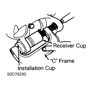

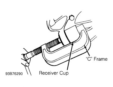

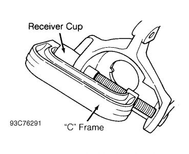

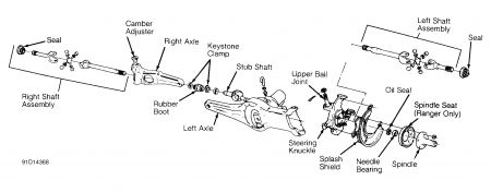

5GEARHEADS
Hi
I wanted to know what special tools were needed to change the the front axel u-joints,and upper and lower ball joints,and lf there is best order of opperations.
Nov 27, 2020 at 8:38 AM (Merged)
BMRFIXIT
  • 19,053 POSTS
Removal 1.Raise and support vehicle. Remove wheel assembly. Remove caliper from rotor. Remove locking hub. 2.Remove wheel bearings, lock nuts, hub and rotor. Remove spindle-to-steering knuckle nuts. Tap spindle with plastic hammer to free spindle from steering knuckle. Remove spindle, spindle seat (if equipped) and splash shield. 3.On right side applications, remove and discard keystone clamp from shaft assembly and stub shaft. Slide rubber boot onto stub shaft. Remove shaft assembly from right axle. 4.Remove left shaft assembly (if required). On all applications, wrap spindle in protective cloth and place second step of spindle in soft-jawed vise. 5. remove oil seal using slide hammer and Seal Remover (TOOL-1175-AC). Remove needle bearing from spindle. Press seal from shaft assembly. 6.Remove the spindle and steering shaft assembly Disconnect steering linkage from steering knuckle. 7.Remove cotter pin and loosen ball joint nuts. Strike steering knuckle near ball joint to release ball joint. Remove ball joint nuts. Note position of camber adjuster on top of axle Remove camber adjuster and steering knuckle 8. Remove snap ring from bottom ball joint socket. 9 9. .Assemble "C" Frame (T74P-4635-C) and Receiver Cup (T83T-3050-A for Explorer and Ranger; D80T-3010-A2 for Bronco and F150) on the lower ball joint. 10. Turn forcing screw clockwise until lower ball joint is removed from spindle. Repeat procedure to remove upper ball joint.
