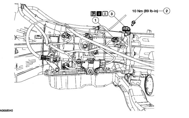

having problems with what I think is the speed sensor. I have already replaced a failing transmission, at only 74,000 miles. Now my truck is starting to do everything all over again. My O/D OFF light will flash at me and my triptometer, (where it shows my mileage) will read only, - - - - - -, instead of the miles. But does eventually go back to the mileage. It also shifts "weird" when this is occurring. What I want to know is, first are there 1 or 2 speed sensors? and then where do I find the speed sensor on my vehicle?

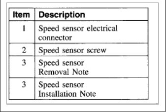

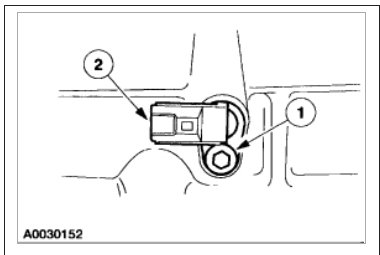

The vehicle speed sensor is located at the rear of the transmission up toward the top of the tail housing here is a diagram set (below) that will show you exactly where it is.

Here is the location for the vehicle speed sensor or the output shaft speed sensor as it is called. The VSS is attached to the transmission, the best way to replace it is to first disconnect battery cable. Then raise and safely support vehicle. Detach the electrical wiring from the VSS then unbolt the VSS from mounting location. Check out the diagrams (Below). Please let us know if you need anything else to get the problem fixed.

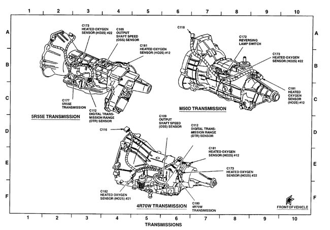

sorry my mistake, your vehicle actually uses a rear axle sensor rather than a VSS. it is connected to the rear axle housing by one bolt and the electrical connector.

it is simply called the rear axle sensor, some may call it a rear speed sensor , should have a red/pink and a light green/black wire running to it. it is part of the ABS that also works as a VSS. i'm not certain why the parts place sold you a VSS for, I am 99% positive that there is no separate VSS on this vehicle aside from the rear axle sensor. Check the diagrams above.

what is the code??? a code never identifies a bad part just a failed system.
it is on the rear differental housing
