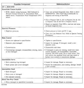

My transmission is slipping when it goes into third and has a weak reverse. I understand I may not have to have it rebuilt. It may be the RD solenoid. And what about TSB 06-13-01?

Fig. 219: Diagnostic Routines - Shift Concern: Soft/Slipping 2-3 Shift Courtesy of FORD MOTOR CO.

thanks for your reply but I can't read what you sent. I increased the font but it made it blurry and can't be read.PLease resend

can yousave it as a picture .. that way you can ZOOM/or enlarge it when you read it .. if i resend it will jusy be the same ??

I saved it in paint and I saved it in windows photos and it's unreadable. Can you send me a link to the site where you got it from? It's unreadable any way I save it even if I zoom it in.

when i open it in paint ... it open's so you can read it but you have to enlarge it/then scroll around the page ??? if i send you the link you will have to pay a subscription for the manual ?? i could try Email ... see if it comes out better for you ???
