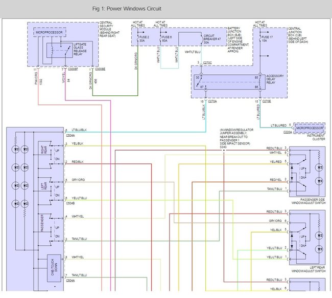

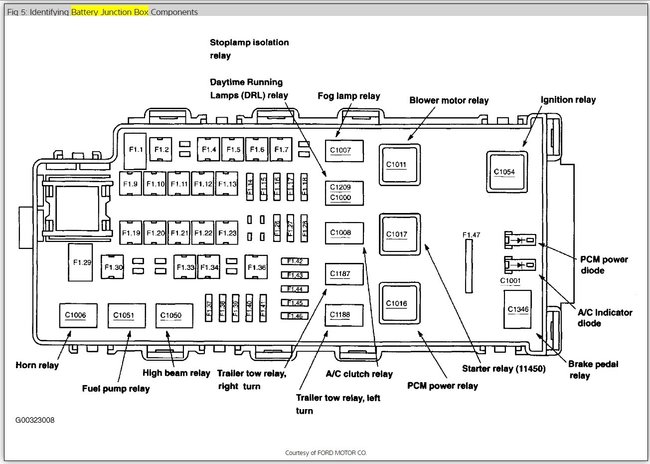

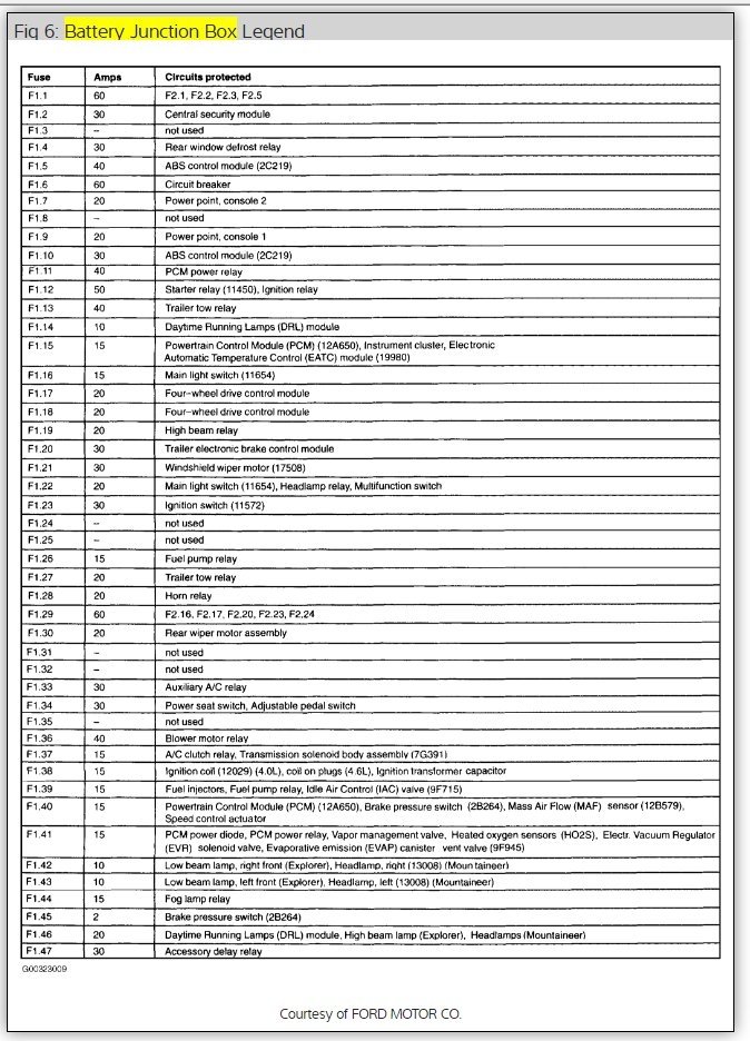

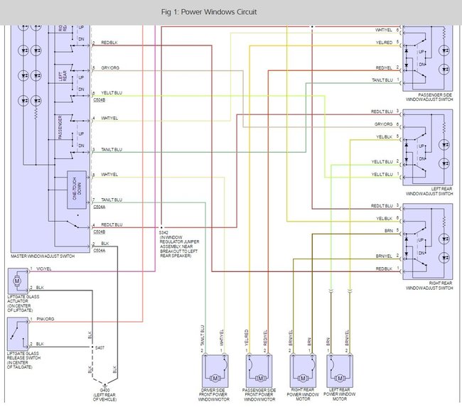

Hey Guys,
I found this wiring diagram that shows two window fuses and the wiring for the window switches so you can do some testing if needed.
and
Please let me know if you need anything else to get the problem fixed.
Best, Ken

Ron I will send testing info via email, also in addition to the tests, look in the rubber conduit for a broken wire, this is pretty common.
https://images.2carpros.com/forum/automotive_pictures/62217_p090_1.jpg
https://images.2carpros.com/forum/automotive_pictures/62217_p091_1.jpg
https://images.2carpros.com/forum/automotive_pictures/62217_p092_1.jpg
https://images.2carpros.com/forum/automotive_pictures/62217_p093_1.jpg
https://images.2carpros.com/forum/automotive_pictures/62217_p094_1.jpg
https://images.2carpros.com/forum/automotive_pictures/62217_p095_1.jpg
https://images.2carpros.com/forum/automotive_pictures/62217_p096_1.jpg
https://images.2carpros.com/forum/automotive_pictures/62217_p097_1.jpg
https://images.2carpros.com/forum/automotive_pictures/62217_p098_1.jpg
Pinpoint Test J: Single Power Window Is Inoperative - Passenger Front Window Normal Operation Under normal operation the passenger front window control switch receives power from the driver window control switch through circuit 170 (RD/LB). The passenger front window control switch provides power to the power window motor through circuit 334 (RD/YE) and ground through 333 (YE/RD) to operate the passenger front window down, and power through circuit 333 (YE/RD) and ground through 334 (RD/YE) to operate the passenger front window up. When operating the passenger front window using the driver window control switch, power is sent to the passenger front window control switch through circuit 314 (TN/LB) and ground through 313 (WH/YE) to operate the passenger front window down, and power through circuit 313 (WH/YE) and ground through 314 (TN/LB) to operate the passenger front window up. Possible Causes  Open in circuits 170 (RD/LB), 313 (WH/YE), 314 (TN/LB), 333 (YE/RD) or 334 (RD/YE).  Inoperative driver window control switch.  Inoperative passenger front window control switch.  Inoperative passenger front window motor.
