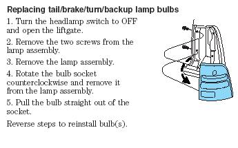

left rear blinker is out how do i change the bulb?

hello my left rear blinker is out how do i change the bulb?

Hello, your owners manual should have that info. The view i copied was the right side, left side should be similar.
