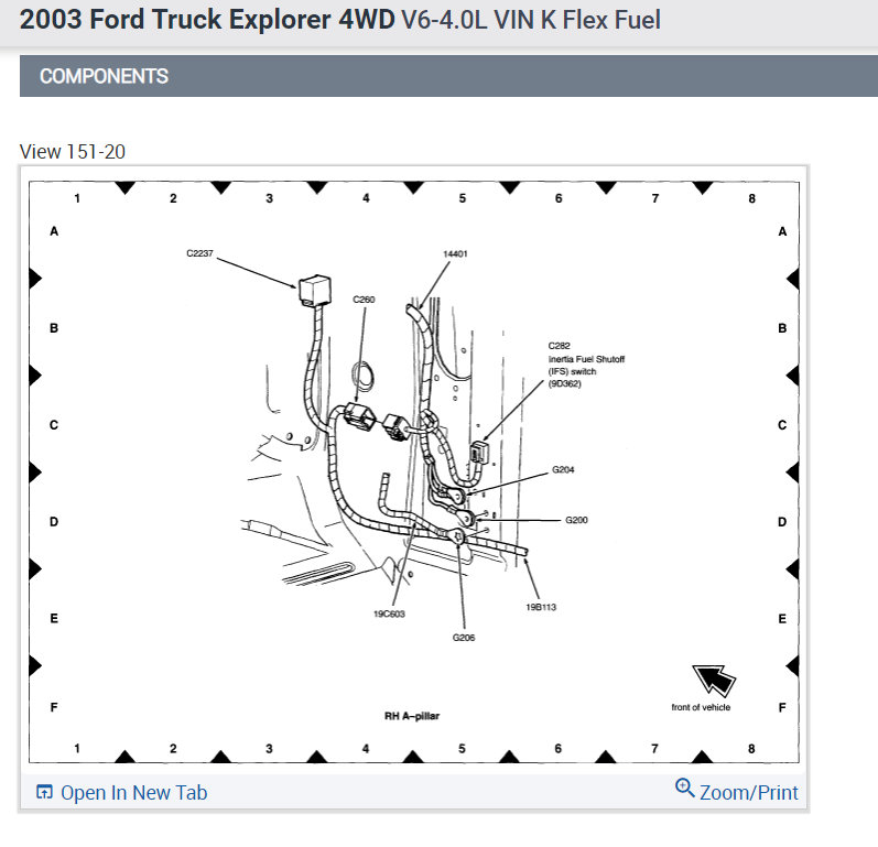

Hi, I'm having a little trouble with my Sport Trac. A few weeks ago, It didn't want to start so i did what any person with a little mechanical knowledge would do...I tried to eliminate the possibilities of where the problem could be. Turns out, i wasn't getting no fuel. I immediately thought it was my fuel pump but later remembered that i once had a Topaz that I crashed and didn't want to start later because the Inertia switch kicked on. I figured, ah, what the heck? I'll try and reset it and maybe that will solve my problems. well, as soon as I did, she fired right up like nothing ever happened. Well today, I get in my truck and start reversing down my driveway, the truck shuts off again and doesn't want to start...I reset the inertia switch yet again, wondering if it would work for me a second time...And it did. My question is whats Happening that my fuel Inertia switch keeps tripping? Do I have a faulty fuel Pump? or is it just the switch that needs replacing? Or am I waaay Off and it is something entirely different? Any Help would be Greatly appreciated. Thanks for your time.

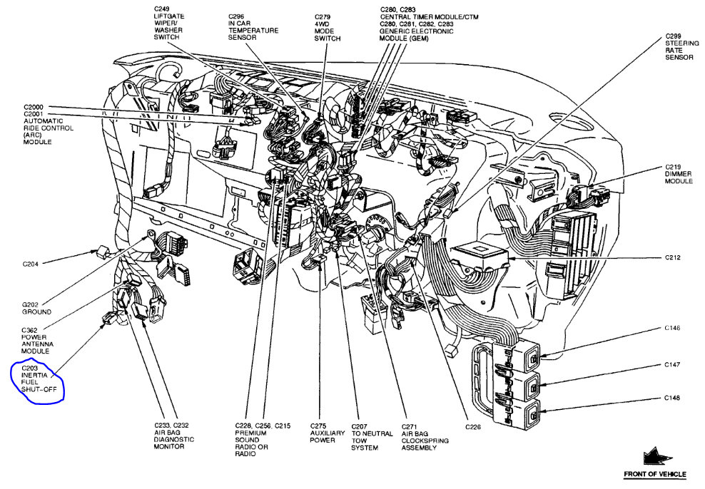

most likely culprit would be the inertia switch itself simply needs replaced here is the location is the diagrams below. Check out the diagrams (Below). Please let us know what happens.
Nov 17, 2018 at 1:00 AM
DON BRAND
In most cases, it is not the switch, it is the connector. It is overheated to the point of losing contact. If the damage it too severe, the switch contacts may also be damaged. I simply bypassed the whole thing to avoid future problems. Ford is about the only manufacturer who utilizes this device. Your choice, either replace the switch and connector or bypass and eliminate the problem all together.

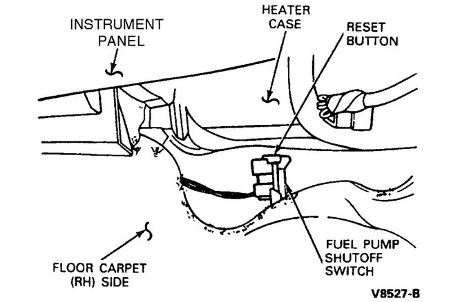

LATERDAYSAND
i think the fuel pump shut off switch was triggered while driving down our super bumpy full of potholes drive way. it turns over but will not start. the problem is, i don't know what this switch looks like. i kind of have an idea of where it is but can't find it.
can you show me what it looks like and where to find it
Nov 26, 2020 at 12:33 AM (Merged)
  • 75,992 POSTS
Explorer its on the right side of transmission hump, underneath carpet on toe board. There will be a shrouded reset button on top
See the diagram below for location

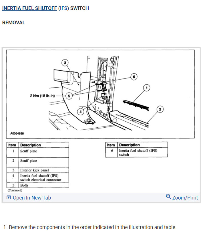

DANNY L
  • 5,648 POSTS
Hello, I'm Danny.
Yes, the inertia switch is located in the right kick panel. I've attached a picture below. To reset the switch use a finger to depress the button. Hope this helps and thanks for using 2CarPros.
