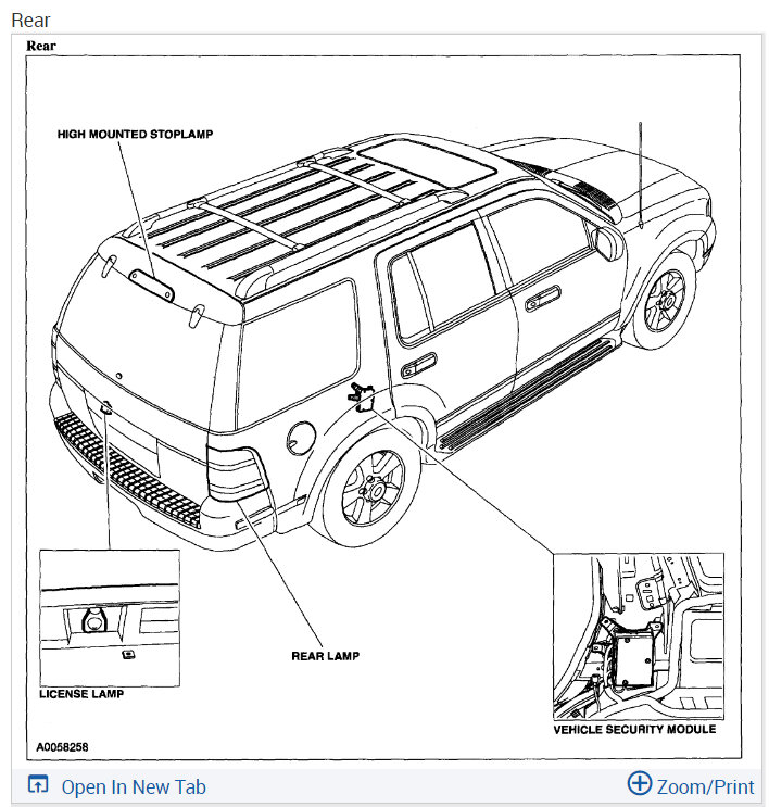

My blinker is flashing fast inside the car and not showing on the tail light. I purchased the replacement bulb but can not see how to replace it. There are no panels on the inside of the truck and nothing under the bumper. Please tell me how to replace the bulb.

Sure, here is how to replace the rear tail light bulb which will fix the problem, please check out this guide as well
https://www.2carpros.com/articles/turn-signals-blink-rapidly
Open the liftgate and you will see two screws that undo the lens.
Check out the images (below). Let us know if you need anything else.
