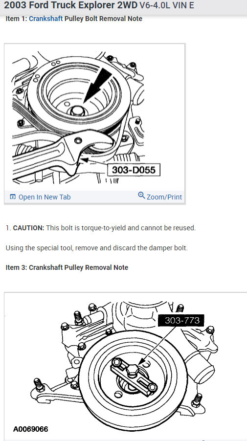

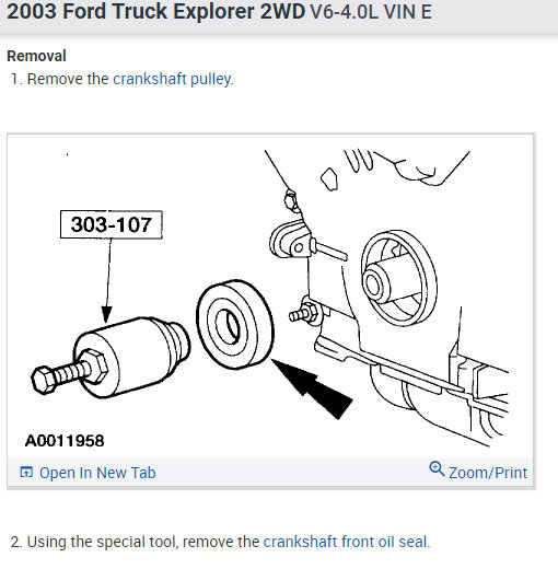

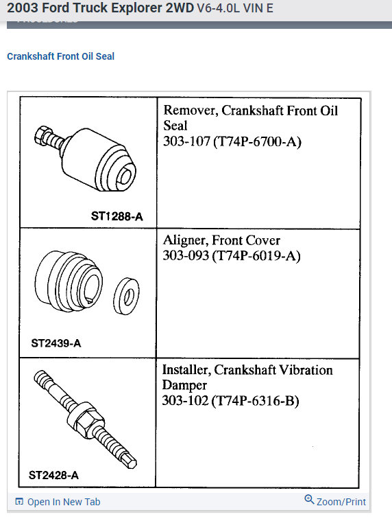

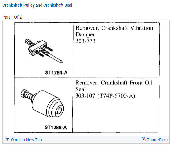

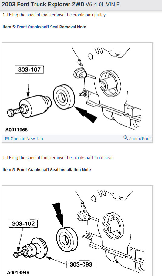

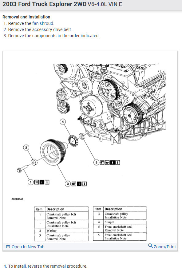

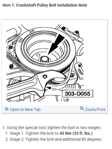

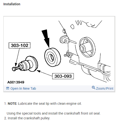

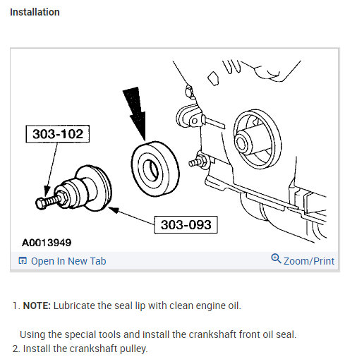

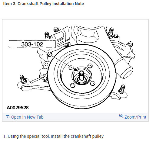

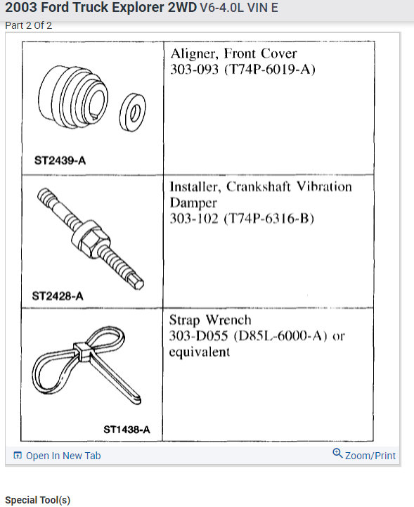

What all do u have to take off from the motor to replace the crankshaft front seal? 2 wheel drive, 4.0 SOHC
Saturday, September 18th, 2010 AT 9:08 PM
SQM
MECHANIC
6,383 POSTS
For the front seal you will have to take off the belt, crank pully (harmonic balancer) and possibly the fan shroud to make room.
Here is a good article that you might find helpful:
https://www.2carpros.com/articles/front-main-seal-replacement
https://www.2carpros.com/articles/how-a-harmonic-balancer-works
https://www.2carpros.com/articles/crankshaft-main-seal-replacement-rear
Let me know if you have any questions.
