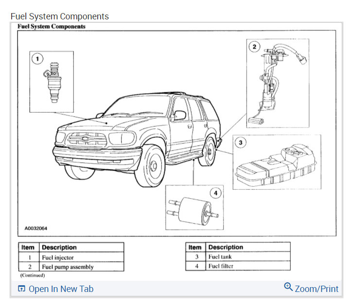

https://images.2carpros.com/forum/automotive_pictures/12900_fp1_2.gif
Fuel Filter is located at the right rear of vehicle above fuel tank. https://www.2carpros.com/kpages/auto_repair_manuals_alldata.htm

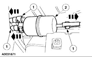

Welcome to the forum. My info says, under the vehicle, driver side, attached to frame. Looks like quick connect fittings, you may a tool to release fittings, the autostores should sell the tool. Make sure there is no pressure on the system, before taking anything loose. Gas may run out of lines, don't let anything electrical be too close. If too much gas runs out, plug the line, till your ready with new filter. The picture is from autozone.
https://images.2carpros.com/forum/automotive_pictures/170934_explorer_fuel_filter_1.jpg

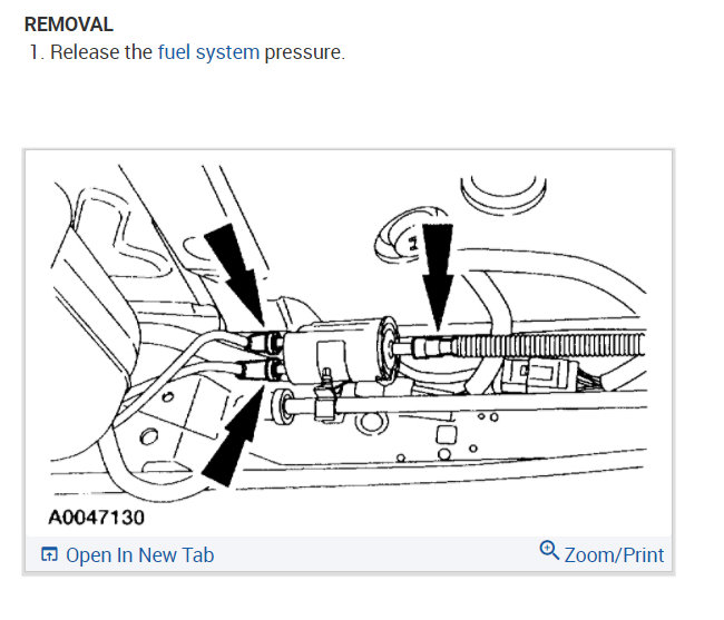

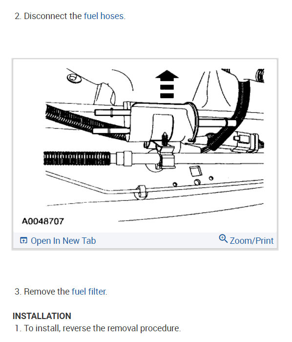

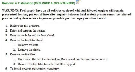

Notes REMOVAL Relieve the fuel pressure. Raise the vehicle on a hoist. Notes REMOVAL Relieve the fuel pressure. Raise the vehicle on a hoist.
https://images.2carpros.com/forum/automotive_pictures/12900_filter_1.gif
Remove the fuel filter shield. 1 Remove the nuts. 2 Remove the shield.
https://images.2carpros.com/forum/automotive_pictures/12900_filter2_1.gif
Remove the fuel filter. 1 Disconnect the fuel lines. 2 Remove the fuel filter from the fuel filter support. INSTALLATION To install, reverse the removal procedure. Remove the fuel filter shield. 1 Remove the nuts. 2 Remove the shield. Remove the fuel filter. 1 Disconnect the fuel lines. 2 Remove the fuel filter from the fuel filter support. INSTALLATION To install, reverse the removal procedure.
