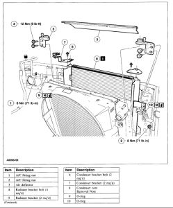

I have a leak in the condenser. how I can change the condenser

CONDENSER CORE REMOVAL NOTE: **Installation of a new suction accumulator is not required when repairing the air conditioning system except when there is physical evidence of contamination from a failed A/C compressor or damage to the suction accumulator. **New O-ring seals, lubricated in clean PAG oil, must be installed before reconnecting any A/C fitting which has been disconnected. 1.Remove the air cleaner. 2.Remove the upper radiator sight shield. 3.Remove the suction accumulator.
https://images.2carpros.com/forum/automotive_pictures/12900_cc_2.jpg
4.Remove the components in the order indicated in the illustration and table. Item 8: Condenser Core Removal Note 1.Position the radiator towards the rear of the vehicle and remove the condenser core. INSTALLATION 1.To install, reverse the removal procedure. 2.Lubricate the refrigerant system with the correct amount of clean PAG oil. 3.Evacuate, leak test and charge the refrigerant system. https://www.2carpros.com/kpages/auto_repair_manuals_alldata.htm
