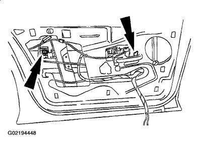

How do you remove the window retaining bolts on the right front window and then repalce the window regulator

raise the front door window glass to the half-open position. remove the front door trim panel. remove the inside glass weatherstrip. remove the watershield. disconnect the lock rod at the latch assembly. remove the bolts (some cases may have rivets) that attach the glass to the regulator. raise window up to full up position and support the window glass. disconnect window motor electrical connector. disconnect regulator and motor assembly from the door frame. remove regulator and motor assembly through door opening. installationg is reverse of removal procedure.
