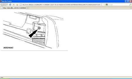

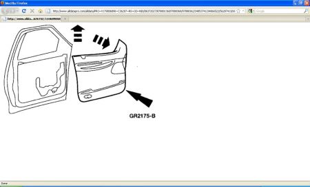

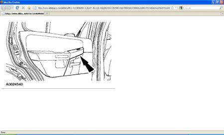

How to remove rear exterior door handle
Sep 8, 2010 at 11:48 AM
SATURNTECH9
  • 30,869 POSTS
https://images.2carpros.com/forum/automotive_pictures/416332_2002_ford_explorer_rear_door_panel_removal_part1_1.jpg
https://images.2carpros.com/forum/automotive_pictures/416332_2002_ford_explorer_rear_door_panel_removal_part2_1.jpg
https://images.2carpros.com/forum/automotive_pictures/416332_2002_ford_explorer_rear_door_panel_removal_part3_1.jpg
https://images.2carpros.com/forum/automotive_pictures/416332_2002_ford_explorer_rear_door_panel_removal_part4_1.jpg
https://images.2carpros.com/forum/automotive_pictures/416332_2002_ford_explorer_rear_door_panel_removal_part5_1.jpg
https://images.2carpros.com/forum/automotive_pictures/416332_2002_ford_explorer_rear_door_panel_removal_part6_1.jpg
REMOVAL 1. Rotate the instrument panel dimmer switch to the position in which the interior lighting is off with the doors open. 2. Remove the door handle bezel from the trim panel. 3. Remove the window switch assembly. 4. Disconnect the window switch electrical connector. 5. Remove the upper trim panel screw at the window switch opening. 6. Remove the lower trim panel screw. 7. Lift the door trim panel by pulling directly upward on the armrest to disengage the panel clips. CAUTION: To avoid damage to door trim panel, do not pull directly outward for this step. INSTALLATION 1. To install, reverse the removal procedure.
