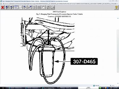

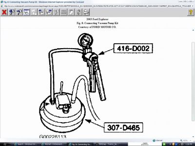

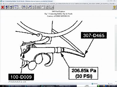

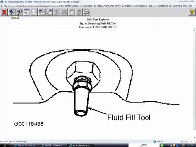

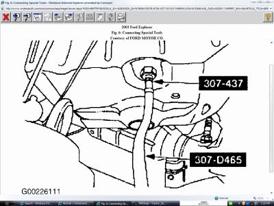

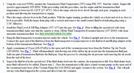

OD OFF light is flashing-------- transmission has been dripping now takes higher rpms to shift--------------------no dipstick--how can i add fluid- so i can drive 40 miles to get it repaired?

Believe it or notn you need these tools, pressure fill now!
