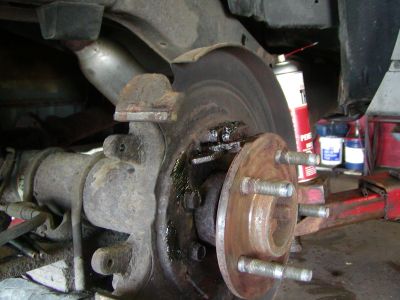

does any body know how to change the hand brake shoes on this car because it seems there is not enough room to remove the springs & the clips from wheel because the hub unit with the lug screws are in the way. thank you. pepperone

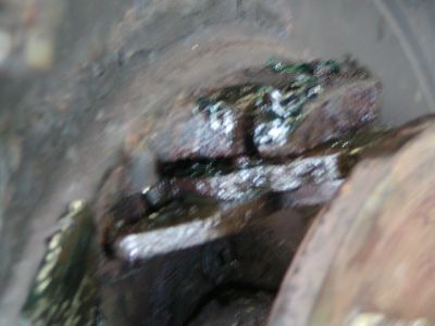

SERVICE WRITER
  • 9,123 POSTS
NAturally I didn't shoot helpful ones other than these two:
https://images.2carpros.com/forum/automotive_pictures/30961_PA080034_2.jpg
The pivots need to be removed, separated and greased, they seize up quite a bit here in the north.
https://images.2carpros.com/forum/automotive_pictures/30961_PA080035_1.jpg

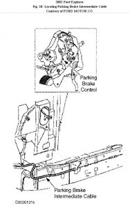

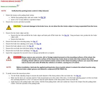

Mitchell offers this:
https://images.2carpros.com/forum/automotive_pictures/30961_explbrakes_1.jpg
https://images.2carpros.com/forum/automotive_pictures/30961_explbrakes20_1.jpg
I haven't done the drill bit thing myself. I attach the lower spring first before using the hold down springs. Although I have attached the one side to the backing plate then the spring. I found a radiator hose pick works good to get the longer spring atached to the other shoe.

I removed the discs on the rear of my Explorer and the shoes fell out! Both sides, the linings had fallen off the shoes. I had to take them to a local shop where they pressed out the hub, replaced the shoes for me, and pressed the hubs back in. Unless you can get a 12 year old midget with tiny hands to do the job, there is no possible way to get the job done in that tiny space between the hub and the dust shield. The pictures show above show 10 times the space that I have on my Explorer.
