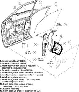

Where is the window regulator on front passenger side

Remove the front door trim panel as follows:
1. Remove the front door handle bezel.
2. Remove the front door window/lock control switch bezel.
3. Disconnect the window/lock control switch electrical connectors.
4. Remove the 3 front door trim panel screws.
CAUTION
To avoid damaging the trim panel, do not pull directly outward to carry out this step.
# Lift the door trim panel by pulling directly upward on the armrest to disengage the panel clips.
# Remove the exterior mirror control switch from the front door trim panel.
# Remove the front door speaker.
# Remove the water shield.
# Disconnect the front door window regulator motor electrical connector.
# Drill a 13 mm (0.52 in) hole using the locator in the door sheet metal as a guide.
Remove the bolts and the front door window regulator motor.
https://www.2carpros.com/forum/automotive_pictures/46384_0996b43f80202aa1_1.jpg
You can also see the 3 bolts that hold the regulator in this pic.
https://www.2carpros.com/forum/automotive_pictures/46384_window_regulator_1.jpg
(I'm sending those pics to your email)
