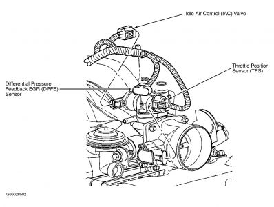

2002 Ford Explorer egr value
2002 FORD EXPLORER
76,000 MILES • V8 • 4WD • AUTOMATIC
IVY
how do i change my egr value on my 2002 ford explorer

https://images.2carpros.com/forum/automotive_pictures/99387_explorev8_1.jpg
check and or replace differential pressure feedback EGR (DPFE) sensor for the EGR its bolted on by two bolts and a tube remove the two bolts after disconnecting the tube and its out
