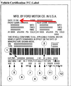

Mike Great job on the info Please do me a favor and look on the driver's door for the attached label and tell me what the date that the red arrow is pointing to The information is asking if it is a late or early model.
https://images.2carpros.com/forum/automotive_pictures/248015_1_129.jpg

The date is 06/02.

Thanks for the info ..you have a Late Production build. You might keep that in the back of your mind for future things.
