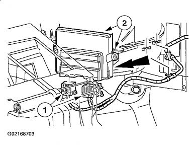

4x4 is engaged and disengages on own after sitting parked overnight or while shopping.
When this first started dash 4x4 light would flicker but now never lights. Bucks when turning for different distances until disengages on own. May or may not go to 4x4 again while running errands.
Only does this after being parked, not while running. Cannot disengage with dash buttons.
New speed sensor installed due to code # P1836. No change, still same problem.
Vehicle is 5 speed manual, 4.0L
Thank you for your time.

Ok after looking into the code you included it tells me that it is the 4x4 control module. It is behind the passenger side of the dash. Here is a pic of where it is. I would check salvage or wrecking yards for on to save money. Make sure they will give you an exchange warranty. Here is the pic.
https://www.2carpros.com/forum/automotive_pictures/249564_Graphic_177.jpg

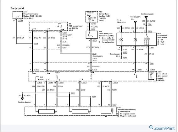

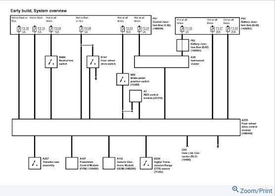

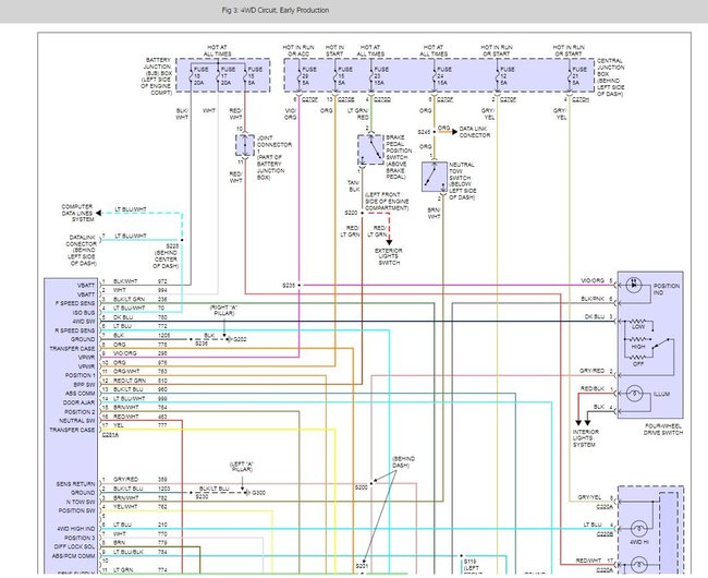

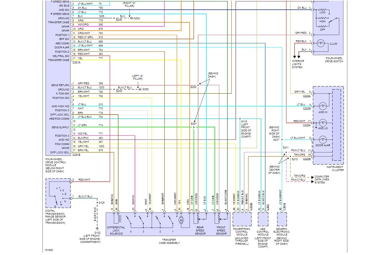

Attached below are the wiring diagrams for the 4wd circuit, you may want to start by checking grounds and connections to be sure they are good
