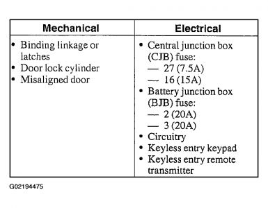

my 02 ford explorer power door locks just up and quit all at the same time.they wont work with the fob or the combination pad outside the door either.i need to know where the door lock relays are located and would love to have a door lock wiring diagram.i already removed the drivers door panel and the rubber wire duct in the door jamb and found a red wire broken and tada!! soldered it and wound up fixing the right rear power window that hasent worked for a year or more lol anyway, the other wires seemed ok in the door jamb area any ideas?

The easiest way to find out what the problem is is to have it scanned for "B" codes, this will pinpoint which part has failed. The central security module controls the door loks, and if using the keypad doesnt work, as it is wired directly to the module, that may be the problem, or possibly a blown fuse. This is the visual inspection list.
https://images.2carpros.com/forum/automotive_pictures/62217_explorer_1.jpg

ok sounds good thanks for the speedy reply.would you happen to know the location of the central security module? thanks.

On the base of the "C" pillar, thats at the tailgate.

ok thanks, i figured it was in the passengers side c pillar because all im getting from the locks is a relay sound comming from there
