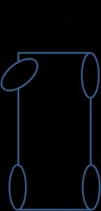

Hello - To better assist you is your model just the Explorer or the Sport or the Sport Trac and can you tell me your engine size in liter and the 8th digit of your VIN Also you said your left front was turned in and your left front was straight. I assume you meant to say your right front was straight? Does the pic below show how it is - The front end being the top of the pic

actually it was the r. front was turned in and the left was straight. I believe it is a bad tie rod. But tell me what you think. engine is 4.0 l

Yes I would have to say you are correct…a broken tie rod….have you looked up under to see?
You will need your front end aligned once fixed if you are doing it yourself. You can install it and adjust it and look at the front of the vehicle and get it where the tire it is sitting pretty close straight to get it to the front end shop.
My big question is why/how did it break….I would look around very good…..was it turned too far out….did it break at the joint itself…..you need to figure that out also in case you have a defective part that made it go bad.

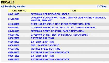

Hello - Also, it looks like you may have some recalls on your vehicle. The dealer may fix these for free. Please contact the dealer service department, give them the VIN number of your car and have them check on these to see if they apply to you.
