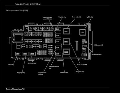

Your analigy of the electrical system is correct. Here is a picture of a relay block:
https://www.2carpros.com/forum/automotive_pictures/249084_relay_7.jpg
On you vehicle it is in the power distribution box in the engine compartment. The starter relay is in location # 6 for a 2001 Ford Explorer.
Also in the power distribution box is a red color 50 amp maxi-fuse for the starter relay/ignition switch.

That helps alot. Thanks for sending it but there's one problem. I can't read the words on the diagram. Can you make the image larger without distorting the words?
Wednesday, February 17th, 2010 AT 12:58 PM
  • 109,885 POSTS
I don't have a way to enlarge the picture. Is it possible for you to save it to a different program and enlarge it?
