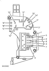

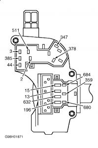

On my Sport Trac The Brake Lamp and the Turn Signal Light on the driver side rear do not operate. The Run Lamp does work. I replaced it with new bulbs over and over again and no improvement. All other lamps front and passenger rear do work. I checked with a light tester and no current in the socket. Pierced the wires near the socket, same thing no current. Checked fuses in Cabin and Engine Compartment. What could this be.

Switch position to left turn and check terminals No. 1&8&10 reading should be 0-4Ohms
