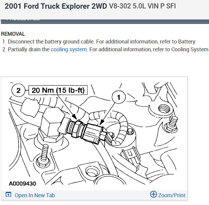

Did he replace sensor or sending unit, some people get confused that there are two different thing, sensors talk to PCM, sending unit talks to instrument cluster(gages)

You can see if the coolant sensor is working by seeing the reading on the scanner, if there is a reading the cluster is bad and needs replacement. To be sure you have the correct sensor this is the location. Check out the images (below). Please let us know what happens.
