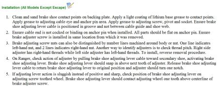

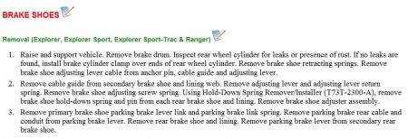

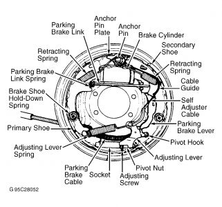

BLUELIGHTNIN6
MECHANIC
16,542 POSTS
SPONSORED LINKS
Sunday, November 7th, 2010 AT 12:56 PM
