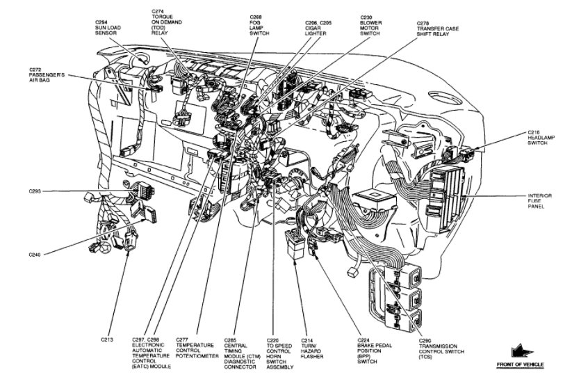

how do i find and replace 4 way flasher

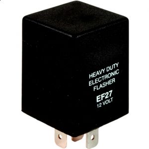

It is located in the front seating area, driver side, behind dash. It's mounted on steering column. Here is what it looks like:
https://images.2carpros.com/forum/automotive_pictures/249084_flash_1.jpg
The flasher just unplugs and plugs in. Let me know if you have other questions. Joe

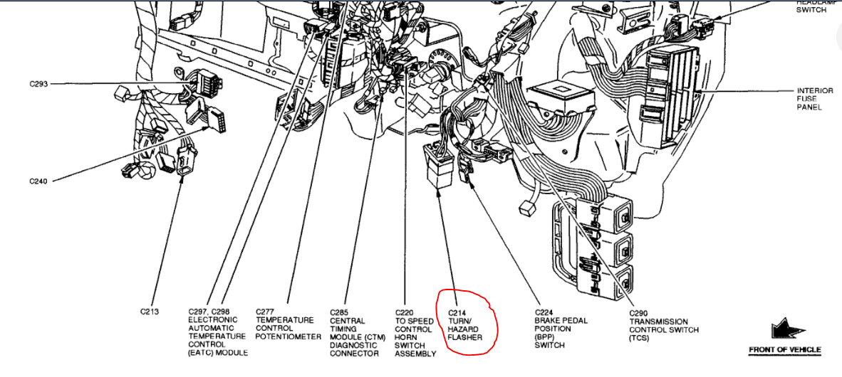

Hello, I'm Danny.
The hazard-turn signal flasher is located under the dash next to the steering column. I've attached a picture below for you and circled it in red. Hope this helps and thanks for using 2CarPros.
