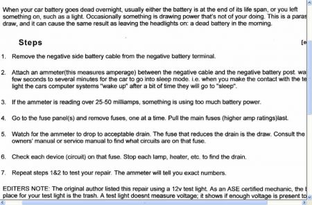

BATTERY AND ALTERNATOR GOOD, BATTERY NOT HOLDING A CHARGE. THE GUY PUT A DEVICE LOOKED LIKED A SCREW DRIVER ON THE BATTERY POST AND A LIGHT CAME ON HE SAID IT COULD BE A LOSE WIRE AND THEY LIGHT WOULD GO OFF ONCE THE PROBLEM WAS CORRECTED WHAT COULD BE THE PROBLEM

If the light remains lit -it means you have a short circuit somewhere in the electrical system.
https://images.2carpros.com/forum/automotive_pictures/12900_parastic_draw_1_219.jpg
