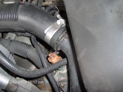

I think I located the sound coming from the hose that connects to the pipe on top of the engine near the thermostat...does that make sense?

Can you upload a photo?

here is the pic

no picture shown?

https://images.2carpros.com/forum/automotive_pictures/301330_HPIM0417_2.jpg

If you are talking about the big fat one, check coolant level and the thermostat, may be hearing a boiling in there, is the fan working?

yes the fat one. coolant always seems to be low...where does it go?
