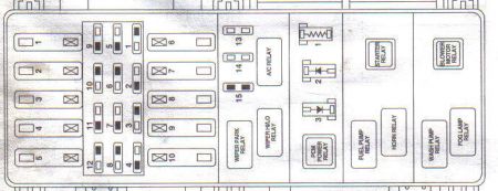

is there fuses in the side of the dash for fuel if so where is it located ?

The fuse is "NOT" on the side of the dash. Open your hood and you will see a different looking fuse box like this:
https://images.2carpros.com/forum/automotive_pictures/433905_explorer_power_dist_panel_fuse_1.jpg
Fuses used in the above box: 1=10A A/C relay 2=20A Aux power point 3= not used 4=15A Fog lamps-Daytime lamps 5=10A Air Bag diagnostic monitor 6=10A Powertrain Control Module (PCM) 7=30A 4WABS module 8=30A PCM relay >>>9=20A Fuel Pump relay and RAP module<<< 10= 15A Horn relay 11=15A Park Lamp relay-Main Light Switch 12=30A Main light switch--Multi Function switch 13=15A Heated O2 sensors, EGR Vacuum Regulator, EVR solenoid,Camshaft position (CMP) Sensor, Cannister Vent Solenoid, A4LD Auto Transmission 14=30A Generator-Voltage regulator #9 - 20AMP fuse in the box pictured above is what you are looking for. Good Luck; Rick
