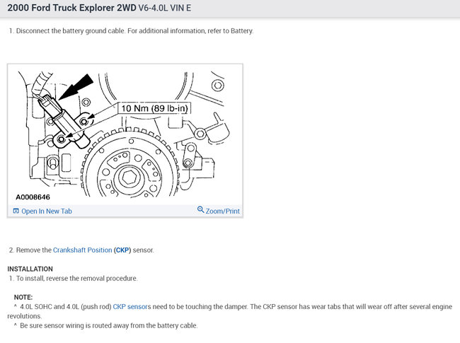

SANDSTORM
how to install crankshaft sensor ?
May 24, 2020 at 7:45 AM (Merged)
  • 110,244 POSTS
Here is a picture of the sensor and the directions for replacing it:
https://images.2carpros.com/forum/automotive_pictures/249084_1_2.jpg
Disconnect the negative battery cable. To remove the CKP sensor, first disconnect the wire harness plug ... Disengage the wiring harness connector from the CKP sensor. Loosen the CKP sensor mounting stud/bolts, then separate the sensor form the engine front cover. Unbolt the sensor and pull it away from the engine-crankshaft damper removed for clarity To install: When installing a new sensor on the 4.0L (VIN X and E), position the sensor against the crankshaft damper. There are small rub tabs which wear off and allow the sensor to be perfectly spaced from the damper. Position the sensor against the engine front cover, then install the mounting stud/bolts. Tighten them until snug. Install the CKP sensor cover and retaining nuts; tighten the nuts until snug. Reattach the wiring harness connector to the CKP sensor. Connect the negative battery cable.
