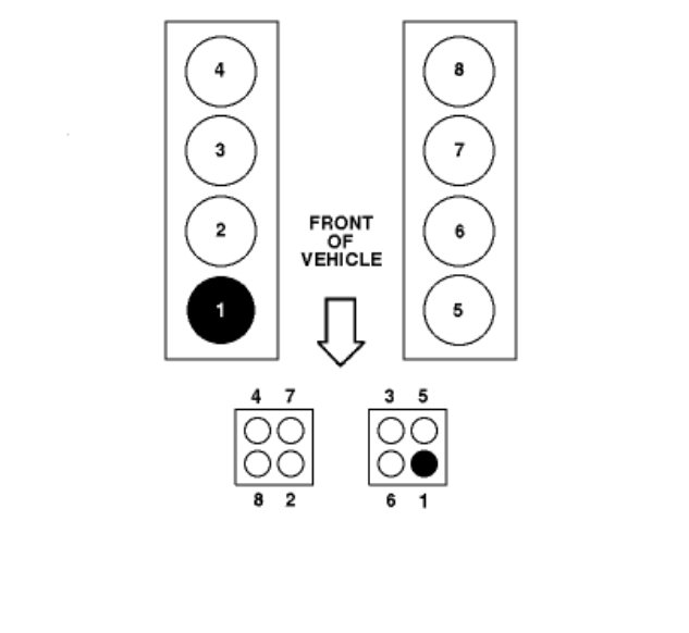

I am doing a tune up and changed wires, but now vehicle won't accellerate. I have a feeling I swapped the wires. Need to know order on the coil pack.

Hello, Here are the orders
https://images.2carpros.com/forum/automotive_pictures/188069_00exploderfireordrvink_1.gif
https://images.2carpros.com/forum/automotive_pictures/188069_00exploderfireordrvinx_1.gif

Here is the firing order for the v8 engine as well (below)
