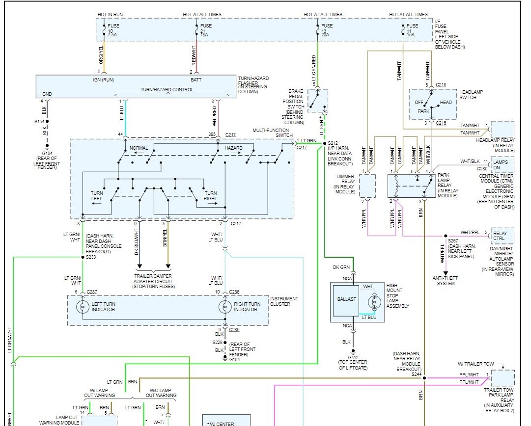

Two lower brake lights don't work, one above hatch does
2000 FORD EXPLORER
146,000 MILES • 6 CYL • 2WD • AUTOMATIC
TIM GRANT
Two lower brake lights don't work, one above hatch does. I replaced the bulbs, and did not find a blown fuse. What else can it be. If the brake light switch was bad, wouldn't the upper light not work also?
Jul 3, 2009 at 11:07 AM
BLUELIGHTNIN6
  • 16,542 POSTS

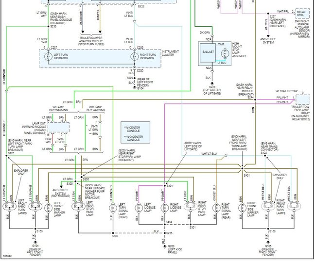

Sounds like a bad turn signal switch, the lower brake lights go through the switch while the 3rd light doesn't Check out the diagrams (Below). Please let us know if you need anything else to get the problem fixed.
