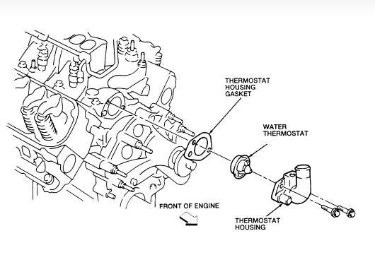

want to see a picture of were it located
Jan 18, 2010 at 8:16 AM
  • 110,248 POSTS
Follow the upper radiator to the engine. It will end on the thermostat housing. Here is a picture:
https://images.2carpros.com/forum/automotive_pictures/249084_temp_3.jpg
Let me know if this helps. Joe

Click image to see an enlarged view
Fig. Exploded view of the 5.0L engine thermostat and related components
4. Remove the 2 thermostat housing attaching bolts.
5. Loosen the bypass hose at the water pump.
6. Remove the thermostat housing. You may have to tap it loose with a plastic mallet or your hand.

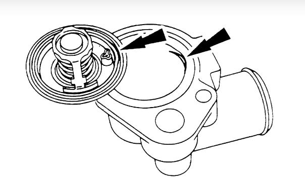

Fig. Align the air bleed hole on the thermostat with the notch in the housing, which is also the 12 o-clock position
1. Clean all mating surfaces thoroughly.
2. Position the thermostat in the housing making sure that the air release valve is in the up (12 o'clock) position.
3. Coat the mating surfaces of the housing and engine with an adhesive type sealer. Position the new gasket on the engine and place the housing on the engine. Tighten the bolts to 12-18 ft. lbs. (16-24 Nm).
