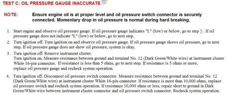

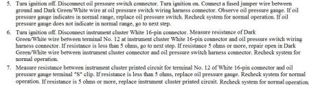

have just change oil pressure sender switch(ford part) but the oil gauge on the dashboard still does not work what is now the likely cause
