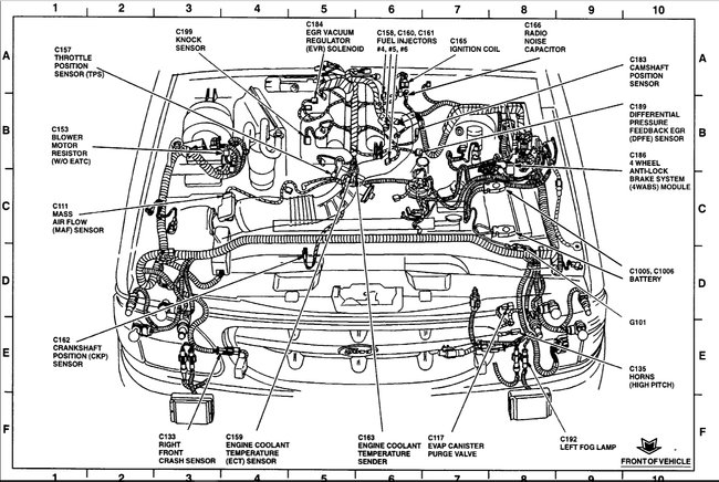

I've a 99 Eddie Bauer, 4.0l E code, 4x2. Bought it new. At about 190K is started to have a cold start problem. Engine cranks, catches but either barely idles and stops or revs really high and stops. After several attempts and using the accelator to rev the engine up/down, and working it it for maybe 2min, it will level out nicely, no misses, no rough idles, and will from that point on, start on command, just like new. This problem seems to appear after the engine is cooled down. The colder the engine and ambient temp, the worse it is and the longer it is before it corrects it is. Check engine code is always 171. Right bank too lean. I have changed both right side O2 sensors (have ones for left side but not installed), replaced MAF sensor, EGR vacuum control solenoid, tested/cleaned EGR, replaced EGR vacuum sensor, replaced plugs and wires, checked for leaking vacuum, and replaced engine coolant sensor (behind thermostat housing). I have read there is a temperature control sensor that feeds to the ECM (TCS) that could be the problem but cannot locate on engine. Anyway, am looking for ideas.
Again, this problem only happens when the engine is cold. I noticed it happening this past summer, but for a much shorter period of time with the warm weather. This winter it is unbearable! I am the original (new car) owner.

This sounds like you have an engine coolant sensor that is not working right. Here is a guide to help you see what you are in for when doing the job.
https://www.2carpros.com/articles/coolant-temperature-sensor-cts-replacement
this guide can help as well
https://www.2carpros.com/articles/engine-cranks-excessively-before-starting
Check out the diagram (Below)

Did you try the coolant sensor?

I really think it will be the engine coolant sensor lets give that a try when you can.
+1
Saturday, November 29th, 2008 AT 10:52 PM
FRONTSHADOW
  • 6 POSTS
Yep should have replaced that from the start engine runs perfect now. Thanks for your help I love this site.
