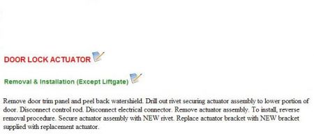

How do i replace the door power lock actuators
Apr 1, 2009 at 1:16 PM
BLUELIGHTNIN6
Experienced Mechanic
16,542 POSTS
Apr 1, 2009 at 5:12 PM
