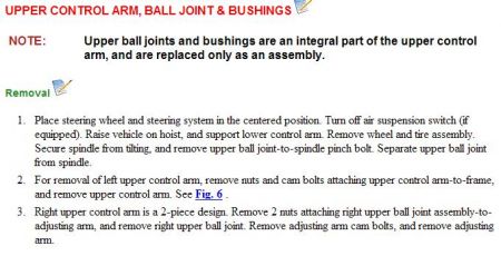

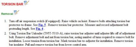

Is it possible for me to replace ball joints myself?
The ball joints seem sound, but the rubber protective boots are deteriorated and need replacement. Can just the boot be replaced?
Purchased new, I have done all repairs on this car, except the transmission or recalls.

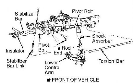

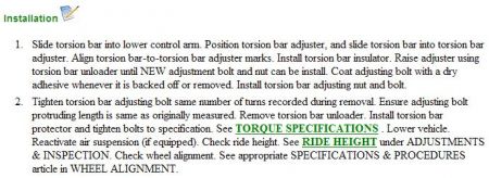

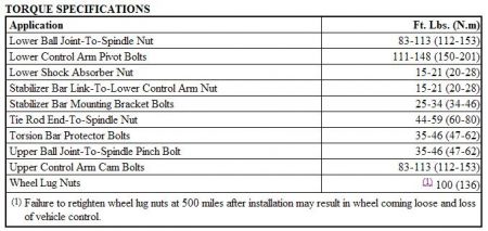

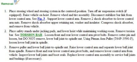

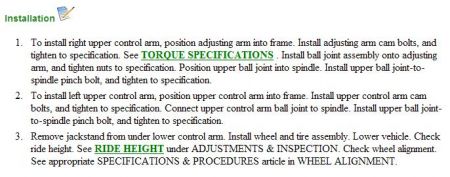

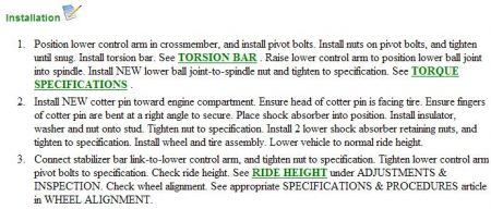

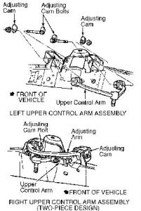

The ball joints and bushings for this vehicle are replaced as an assembly only. Below are instructions for top and bottom .
UPPER
https://www.2carpros.com/forum/automotive_pictures/261618_Noname1_1.jpg
FIGURE 6
https://www.2carpros.com/forum/automotive_pictures/261618_FIG6_1.jpg
https://www.2carpros.com/forum/automotive_pictures/261618_Noname2_26.jpg
https://www.2carpros.com/forum/automotive_pictures/261618_specs_2.jpg
LOWER
https://www.2carpros.com/forum/automotive_pictures/261618_Noname1_2.jpg
https://www.2carpros.com/forum/automotive_pictures/261618_Noname2_27.jpg
FIGURE 3
https://www.2carpros.com/forum/automotive_pictures/261618_FIG3_1.jpg
https://www.2carpros.com/forum/automotive_pictures/261618_tb_1.jpg
https://www.2carpros.com/forum/automotive_pictures/261618_tb2_1.jpg
