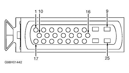

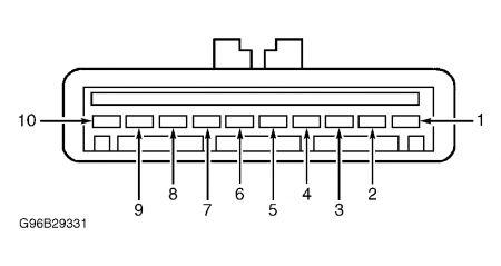

Ok with that it is saying that the cruise control will go into the test and the first test passes but that is it so the VSS needs to be tested now ok. First check fuse number 10 it should be a 7.5 amp fuse make sure it is good. Other wise I need you to unplug the cruise harnes and then the abs harness and do a ohm test between the servo module connector number 3 and the abs module harness connector number 10 let me know what the ohms is and this test is done with key off. Here are the pics of the harnesses so you know what term it what. Cruise harness
https://images.2carpros.com/forum/automotive_pictures/249564_Graphic_39.jpg
The ABS harness
https://images.2carpros.com/forum/automotive_pictures/249564_Graphic1_1.jpg

The fuse checked out okay.
Between the cruise harness connector 3 and ABS harness 10 is: 0.3 ohms.

Ok with that test it say's the speed servo is bad. However this don't answer why the speedo don't work so lets do another test on the VSS.
Now with key off unplug the speed servo connector and hook you multi meter between term number 3 and ground and set it on ac setting and drive the car after 30 mph it should give you a voltage reading let me know what you find. If you get nothing then the VSS is no good and needs to be replaced.
