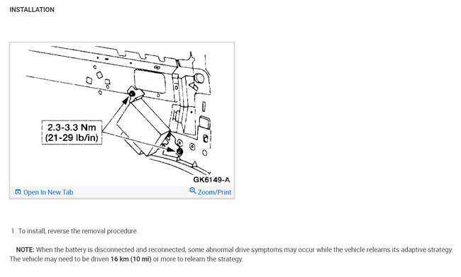

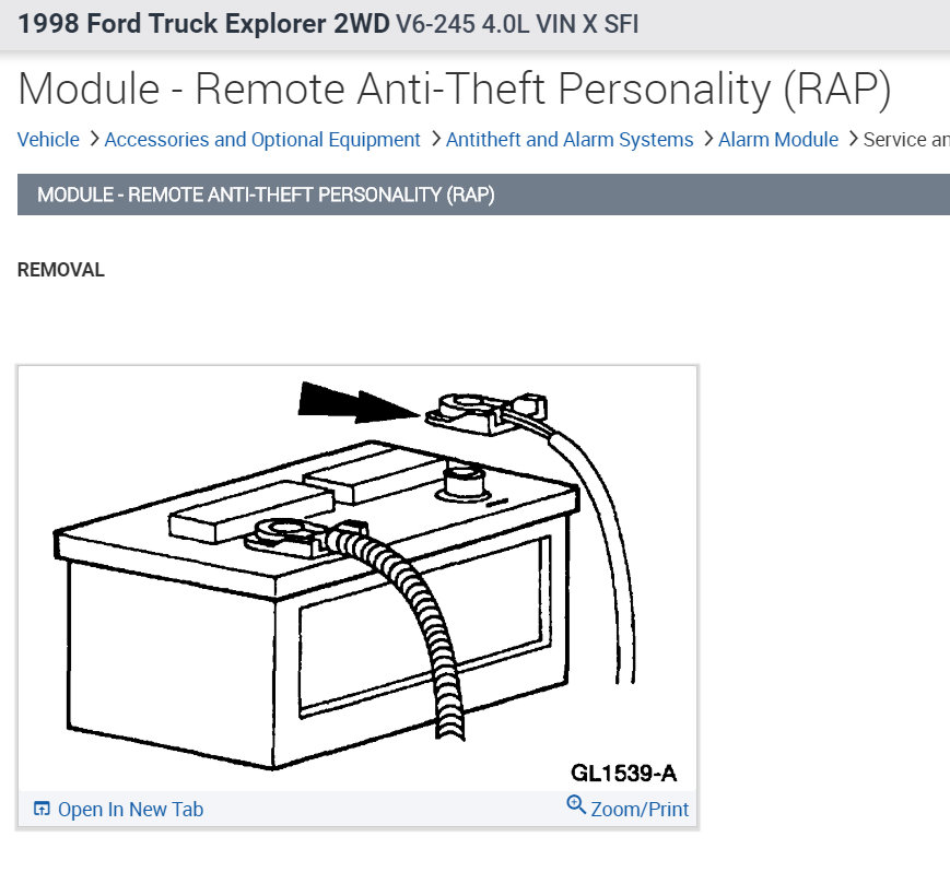

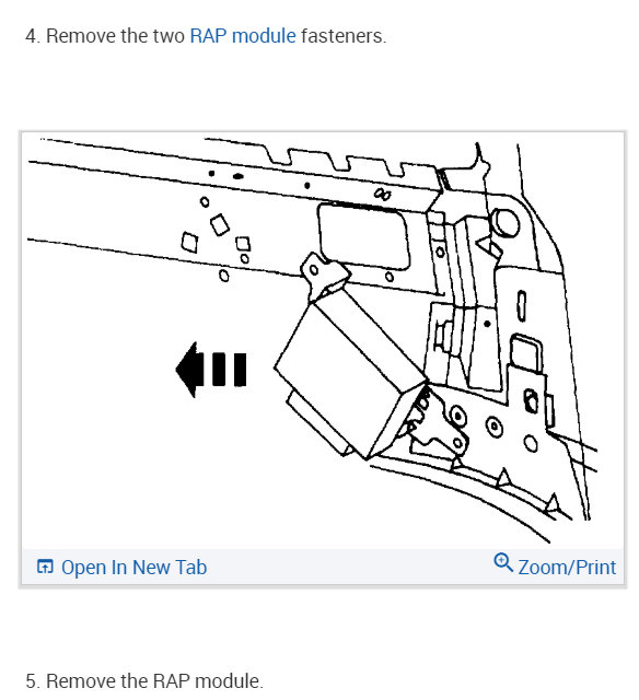

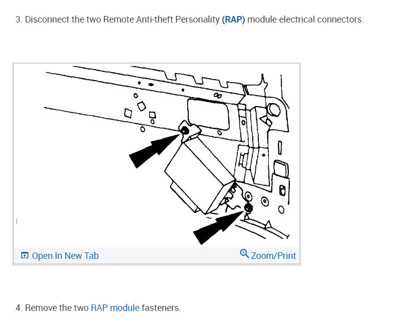

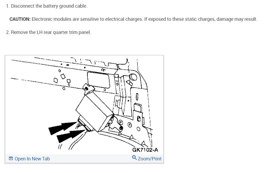

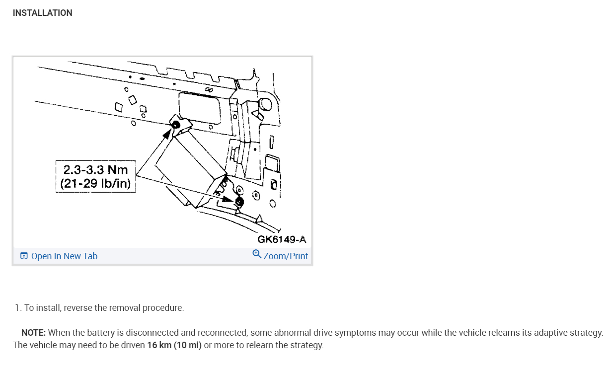

Hi
The RAPS module is in the rear on the right side. Here are the instructions to change it out in the diagrams below. Check out the diagrams (Below). Please let us know what you find.
