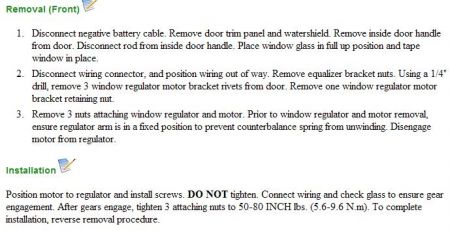

How do you remove a driver side power window motor
Aug 27, 2009 at 6:21 AM
BLUELIGHTNIN6
  • 16,542 POSTS
https://images.2carpros.com/forum/automotive_pictures/261618_Noname_317.jpg
Aug 27, 2009 at 7:21 AM
