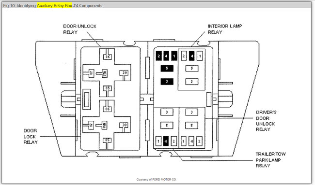

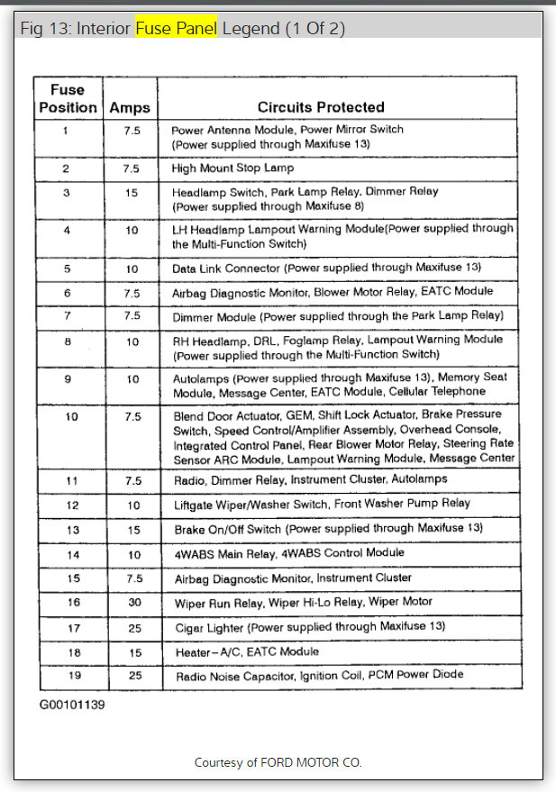

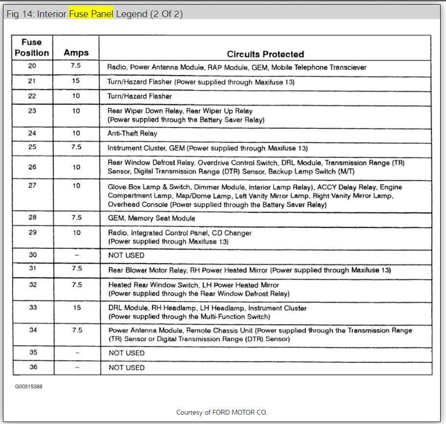

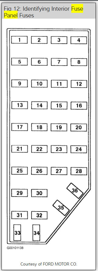

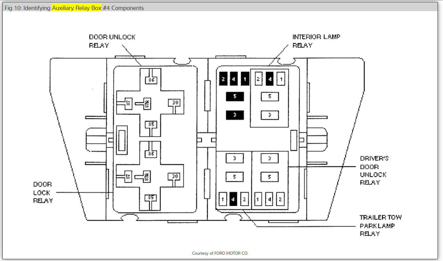

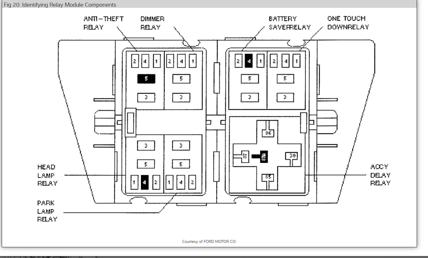

My dome lights are no working. Also my drivers side window is down unable to make it go up also the other windows don;t work. I removed rubber boot on door and none of the wires are broken. I interchanged reloays under the hood but it doesn;t seem to matter. Could it be the master switch on drivers door?
Apr 17, 2009 at 3:39 PM
  • 55,561 POSTS
Hey MOESHA70,
Here are diagrams (BELOW) for both the inside and under hood fuse box panels and relay locations. Here is a guide to help you test the fuses. Check the fuse locations in the diagrams below.

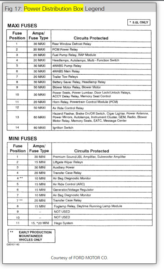

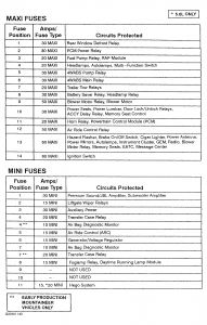

Electrical problem 6 cyl All Wheel Drive Automatic 400,00 miles
I have a 1997 explorer with 400,000 miles. I replaced the 4x4 switch on the dash, now I need to find which fuse runs it. It did not come with an owners manual and the Haynes manual does not show a fuse diagram. Any help would be appreciated as this is a daily driver, (300-400 miles a day).
Thanks.
Jan 13, 2020 at 12:31 PM (Merged)
  • 55,561 POSTS
Hello, Here is a guide to help you test the fuse when you find it. https://www.2carpros.com/articles/how-to-check-a-car-fuse Large diagrams BELOW
https://images.2carpros.com/forum/automotive_pictures/266999_GraphicCA3IXJEQ_1.jpg
Below are the full size fuse and relay diagrams for the whole car, you should save this in your favorites for future reference as well. Check out the diagrams (Below) Please let us know if you need anything else to get the problem fixed. Cheers, Ken

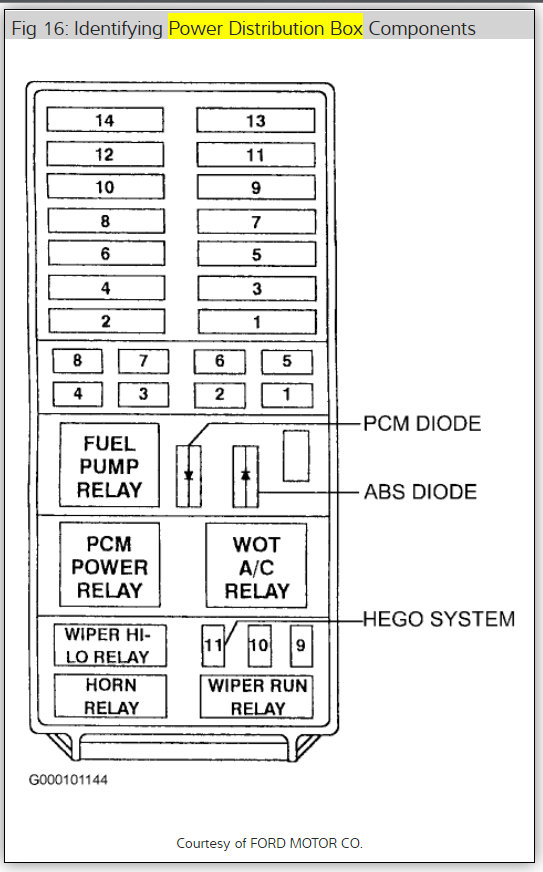

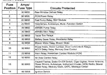

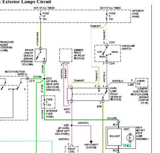

I need a schematic of the fuse panel so I can locate the proper fuse for my brake lights
Jan 13, 2020 at 12:32 PM (Merged)
DAVE H
  • 13,383 POSTS
the high mount stoplamp has fuse #2 in interior fusebox rear stoplamps use fuse # 13 in underhood fuse/relay box..
